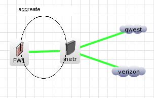

You can place your own label on most things just change the appearance… [myfunction()]
I have never seen a way to place a function in the “settings” for the link to get graphs from that function.
You can add the function to a probe then you will get a graph. Add the probe to the router… Check out the probe thread.
Why not place two statics on your map from your router to the two providers and an inside link for the aggreated bandwidth?

Definetively a was in a foolish day. That’s the better approach, to monitor in the Cisco LAN Interface.
