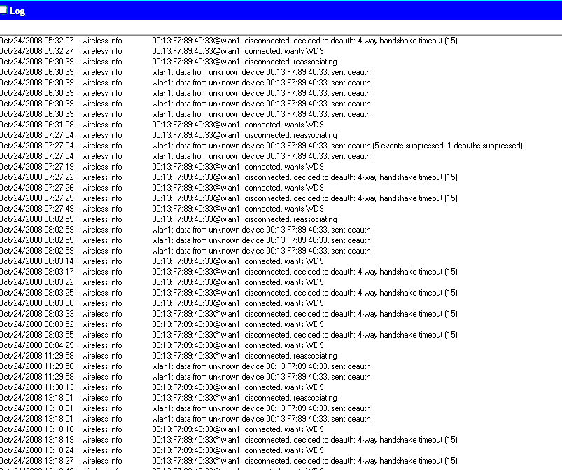

link disconnect ..almost same time everyday..error
disconnected, decided to deauth: 4 way handshake timeout(15)
disconnected extensive data loss
data from unknown device 00:13:f7… ,sent deauth
this what i got from log… mt1= Ap with wds mt2=station wds
what s the problem and how i can fix.. this happen almost everyday 2 or 3 times.. but the strange it reconnect after 5 to 10 timeout..
sometimes only 4
any help plz

mt1: ap bridge with wds dynamic signal stenght -62 signal to noise 36
mt2: station wds signal strenght tx/rx -60/-66 tx/rx ccq 83/86 signal to noise 22
using 2357 channel to avoid noise on 2.4 channels
wireless card used for about 4 month..and always this problem..
the strange is that all day its working very good.. ping 1 -2 ms and not even 1 timeout..then disconnected for about 2 minute. and reconnected ..every day almost same time.
i read that this error come from weak of signal.. but i think idont have this problem cause its working very good all day.

in debug log help it say its signal problem… but my signal very good…ping 1 or 2 ms.. -62db
this is the log
