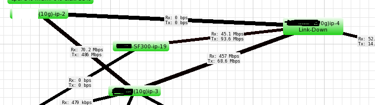

Hi al
i am here again to get help from experts so please guys help me regarding my dude link down notification with colour change
as i can see old post in this forum about this but i cant understand becoz its in older version i am uploading pic from my dude
As you can see between device ip 2 has link with device ip 4 and its down
but we can reach device ip 2 via device ip 3 to device ip 4
so what i need i dont know when device 1 and device 4 link was down
so guys please help me regarding this and is their any other way to get color change when link is down
now color changes when speed of that link is changed or become red when it using it maximum capacity

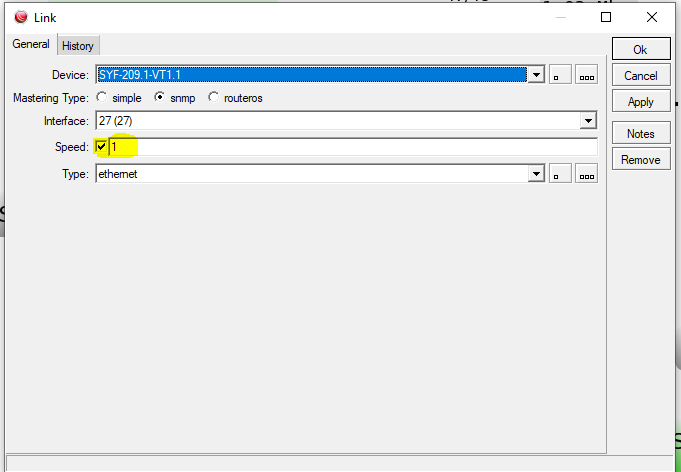

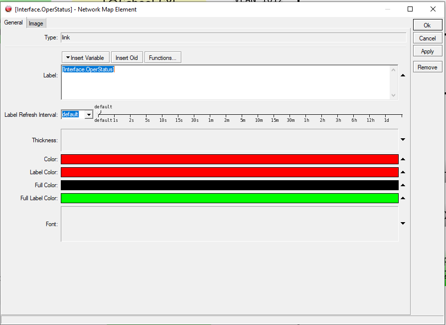

Short Answer, see attached Pictures:
