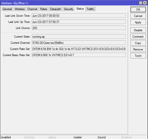

I’m running some WAP AC’s through CAPsMAN, when I view the interface status the CAPS controller, I see lots of “Link Downs” in the status tabs.
All Devices are set so the channels do not overlap with one another, The network is currently on 6.39.2.
If the CAPS controller is logging these link downs, does it mean the AP has gone down 293 times?
Has anyone else experienced this?
Hi Cameron,
I think you’ll find that this happens when that interface has no clients associated with it.
Cheers
Great, nothing to worry about I guess.
Thanks!
