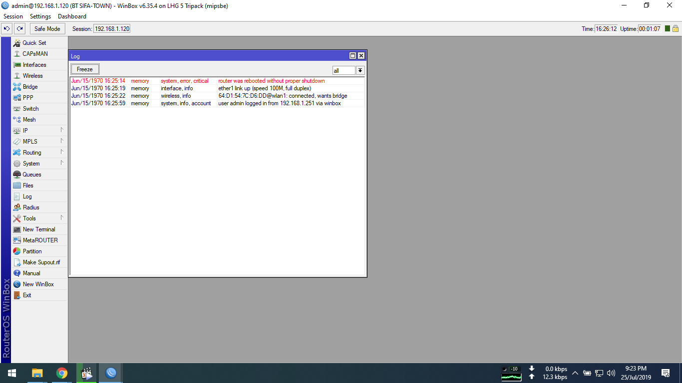

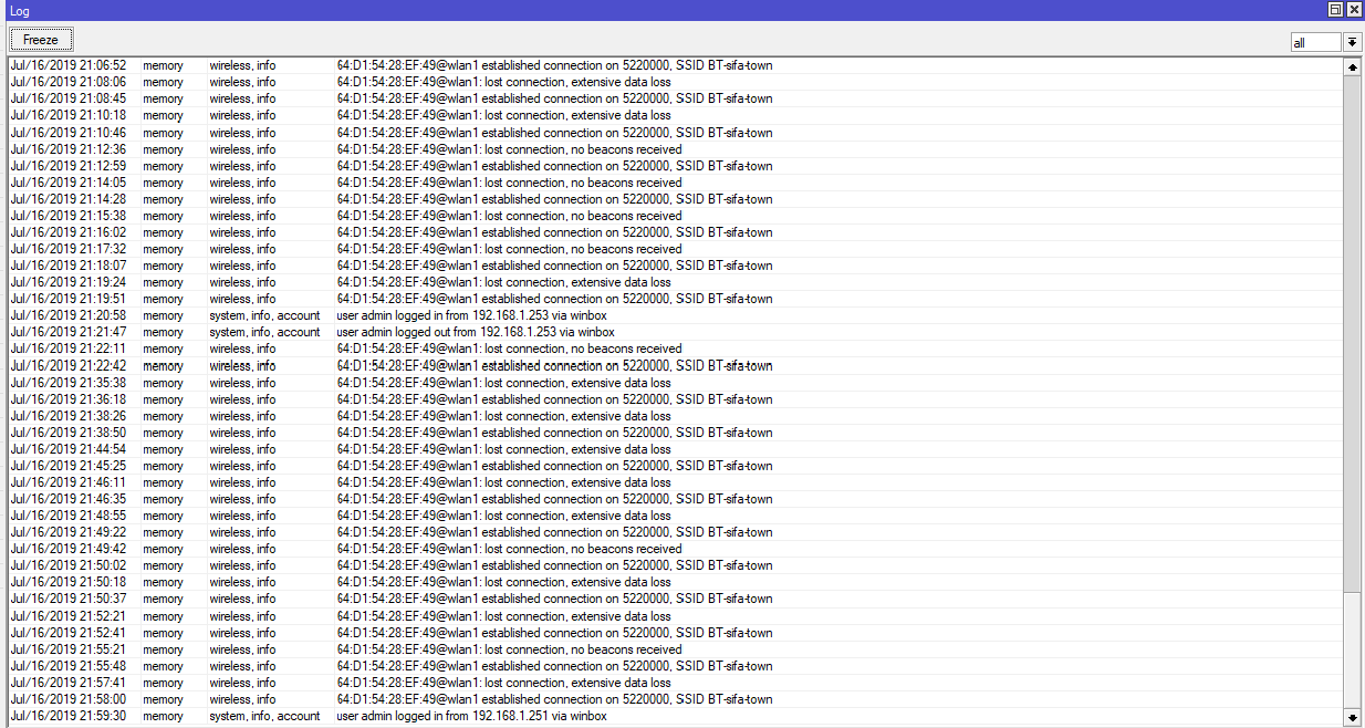

I have an issue which i have been facing for a couple of days, my internet keeps dropping every few minutes. I have a point to point link which is approximately 1.5 Km’s and i’m using LHG5 on both antennas.
192.168.1.69 is the slave, 192.168.1.120 is the master.
I have attached logs from both devices; on the slave the logs show: lost connection. extensive data loss
I have gone through https://wiki.mikrotik.com/wiki/Manual:Wireless_Debug_Logs, but can’t figure out the exact issue,
The frequency and CCQ are all fine and getting a solid -55/-57 on the slave with ccq of 91/95
Hope you can shoot some recommendations my way, will appreciate any help on this.
