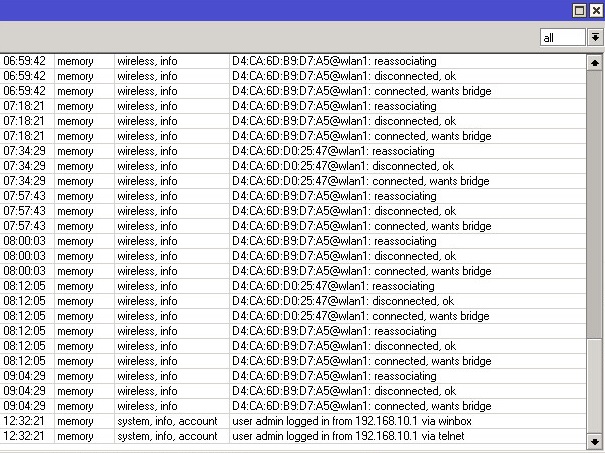

I have a Sextant AP with 4 SXT client wich is connected to it with nstream protocol
sometimes clients have constant cennecting and disconnecting with this debug info that attached.
i appreciate give a solution for this
the client are connected on “station” mode or on “station bridge”? enable “bridge” flag on wireless settings.
tnx for ur reply All Stations are on “station-bridge” mode.
what do u mean flag bridge in wireless setting?
I do not know why you need station-bridge, but if you enable station-bridge, on wlan1/Wireless settings Bridge Mode must be set to “enabled”
