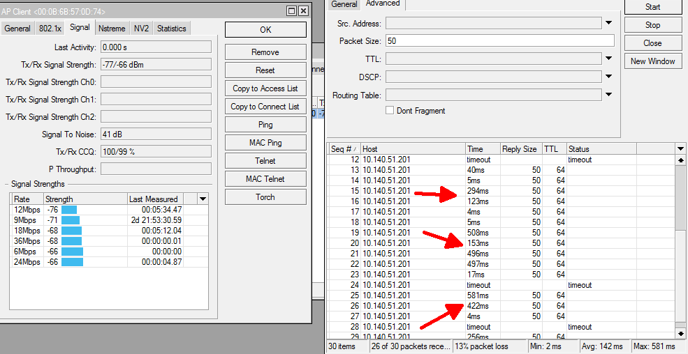

I have a 3km link, 5Ghz.Tx/Rx is 77/66; this should be enough for a stable link
For some reason I have randomly huge delays in ping.
Usually I get 2 ping around 5 ms and then a few around 500ms
I am using version 6.40.1
CPU is about 30% without any special routing features
Any idea what it might cause the problem?

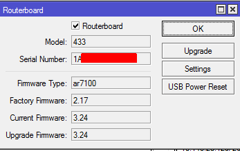

Which devices are you using? Is this a PTP or a PtMP? What’s the System > RouterBoard Current vs Upgrade Firmware on both?

BR433 on my side with cm9 cards
Firmware seems updated:

Signal is too low. It will never work as it should. You have a problem if for 3km and dish signal is -77.
Also a stable link should have at least -65. -50 to -60 recomended for full speed also.

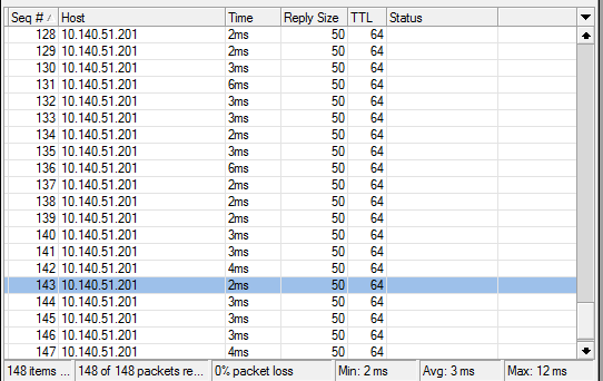

After doing some changes link is now constantly -66/-66 both ways and RTD is more constant

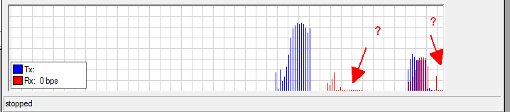

However, I see huge difference in badwidth test:
Sent traffic reach 27 Mbits, receive constant to 1mbit with some 15 mbit peaks: this shows on which side of the link is a problem?
That looks much better.

Those are your Tx rates, your problem is on Rx, so the rates you would have to lock are those on the AP. That’s why I asked if it was a sector or a PTP; if it’s a sector and you lock down rates, you’ll be locking down rates for all stations, highly doubt your WISP would agree on that.
