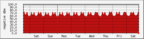

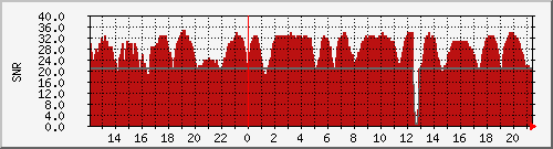

JP,
What am I looking at here?
These are signal graphs of radio links over water. Tide, and to a lesser extent thermal differences, have a HUGE effect on the signal if the link shoots over water, and either end is within 1/4 mile of the water.
Try using a 5.8 signal splitter, and 2 antennas.
You will have to play with the antenna seperation.
The idea being that the reflections will out of phase somewhat at each antenna, and will have a reduced effect on the performance of the link(s).
