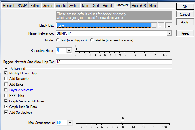

Did you check auto discover settings? What does add networks add links and layer 2 structure do? Sorry I don’t use auto discover so you might need to do some testing.

I think normis says right in general, but i thought may some feature exists like Cisco CDP. I saw topic in which people upload their network maps. Are they manually add links between network devices or not i don’t understand. Will try to ask there=)
I have always added the links between devices manually. I used autodiscover once or twice when I first started using The Dude but only got the devices connecting to a subnet as you have experienced.
