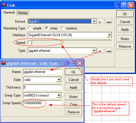

Are you asking for packet throughput?
You can modify the speed of an interface directly on the link or use the default built into the type.
Maybe your gigabit Link Type is not configured correctly?
No, gigabit ethernet was bad example, because of still troughput rate.
( I confirm my configuration looks exactly the same )
