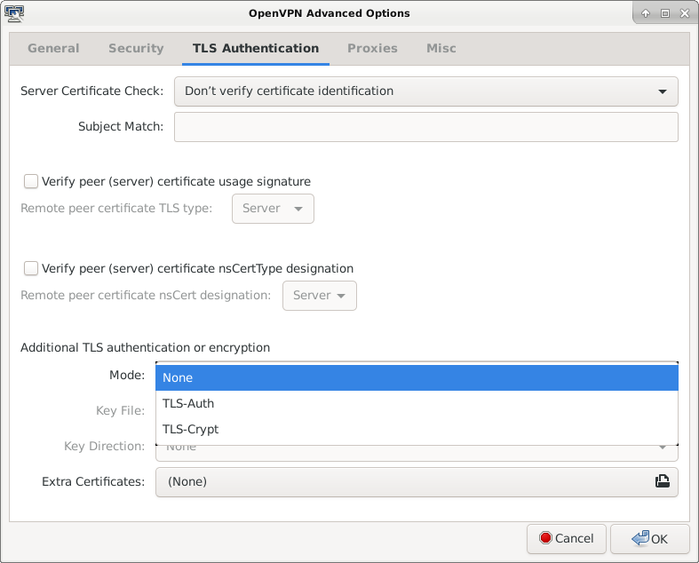

Have you enabled TLS-Crypt or TLS-Auth for the VPN configuration on the Linux client? If you have, you will need to disable it as RoS 6 doesn’t support it (I don’t know if RoS 7 does).
Take a look at the screenshots if you don’t know where to find the setting.
