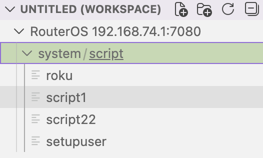

I'm working on adding a "Virtual Script File System" for my TikBook VSCode extension.
Currently wired up /system/script, but trying to fill in the rest of "script attributes", so they can be edited/saved directly in VSCode.
But there is no way to "find" all attributes that support RouterOS script, so I've come up with a list of what, I believe, are most of them. Various monitor do={} scripts are ignored since they are not saved tto config
Here is what I came up with & amended based on @xrills and @tdw comments.

I'm working on virtual FS for VSCode so you can navigate to any script location, and edit it in VSCode. Since it's virtual file system, things that are not actual "events" wasn't my focus.
Here is what I've (well, me yelling at CoPilot) show for the perisited attributes. I still need to audit with my top post, and I still have some a few throny issues to resolve when I have more time (like netwatch without name, host can be dup too & logging/action/target=script is actually a "symlink"... basically anything without a unique name attribute [so needs backs to .id/etc]).
Virtual Filesystem Structure (rscfile://)
