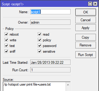

In script, do you have correct permissions set?

Yes…this is the script configuration. And the whole script (there isn’t more lines).
