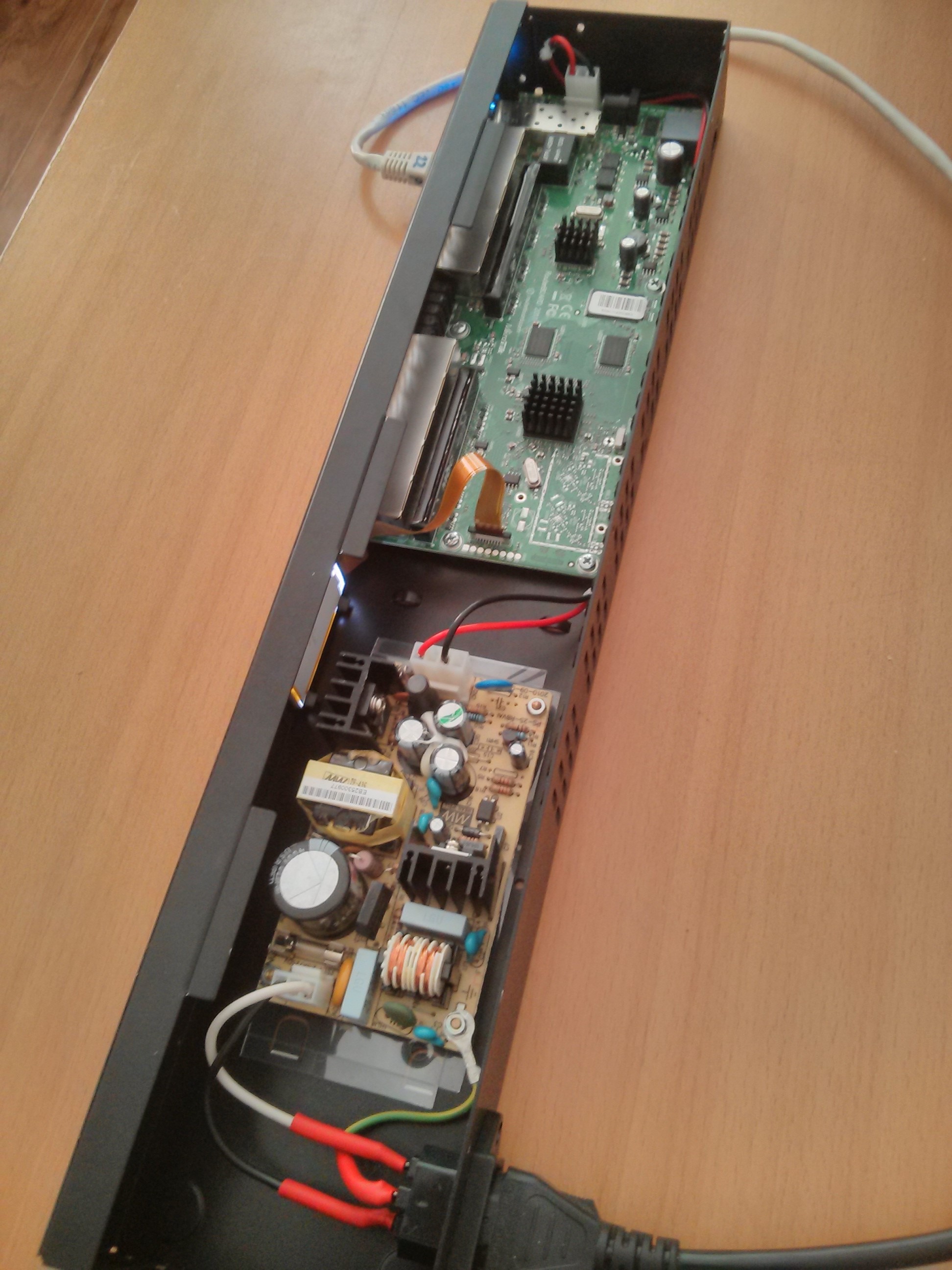

After all, I did some modification to my unit. I have added internal power supply module and power socket. Hopefully it won’t blown away :slight_smile: One more thing, the unit with attached rack mounting clamps it little bit to wide so I had to use more force to mount unit in the rack (standard Triton).

Great job on the internal PSU.. That’s how it should have came.
