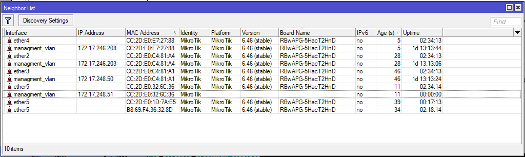

We observe strange behaviour with LLDP where certain connected accesspoints are not listed, which we can not explain. In Neighbor-Discovery on Port 5 we only see 1 AP of the expected 3 AP.
But when i look at the SSTP-Server, i easily see the connected AP in Neighbor-Discovery

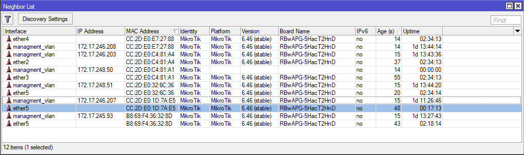

Now, when I change ARP mode in “management_vlan” from “enabled” to “proxy-arp” on MikroTik hEX suddenly all AP are visible. This will only last for ~180s, until the Age (s) Threshold is reached. Then the previously missing AP will be missing again.
I am looking for a solution, so that LLDP will work correctly again. Does anyone know why this might occur?

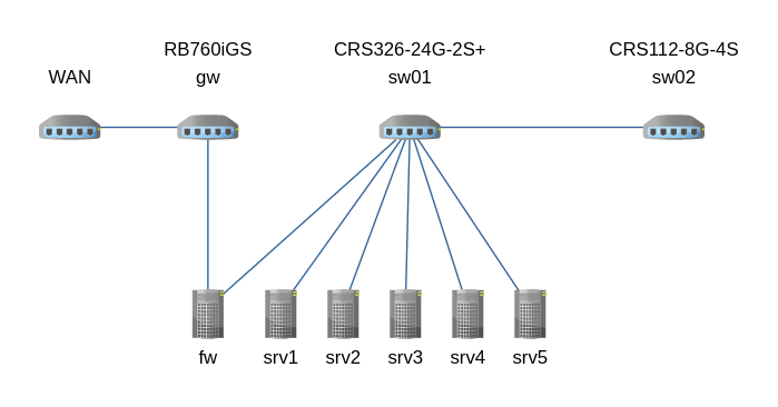

This is roughly how my Network looks like. All Server are in the same VLAN. The mgmt interface from both switches is also in the same vlan.
sw01
[admin@sw01] > ip neighbor print
# INTERFACE ADDRESS                  MAC-ADDRESS       IDENTITY   VERSION    BOARD
0 mgmt      x.x.x.101                00:1E:06:xx:xx:xx srv1   <--- partly broken. connected to ether1 not mgmt interface!
1 mgmt      x.x.x.102                00:1E:06:xx:xx:xx srv2   <--- partly broken. connected to ether2 not mgmt interface!
2 mgmt      x.x.x.103                00:1E:06:xx:xx:xx srv3   <--- partly broken. connected to ether3 not mgmt interface!
3 mgmt      x.x.x.104                00:1E:06:xx:xx:xx srv4   <--- partly broken. connected to ether4 not mgmt interface!
4 mgmt      x.x.x.105                00:1E:06:xx:xx:xx srv5   <--- partly broken. connected to ether5 not mgmt interface!
5 mgmt      x.x.x.251                CC:2D:E0:xx:xx:xx sw02   <--- partly correct. sw02 is connected on ether23 not mgmt!
[admin@sw01] > ip neighbor export verbose
set discover-interface-list=!dynamic lldp-med-net-policy-vlan=disabled protocol=lldp
sw01 is not showing the firewall - tcpdump shows that there are LLDP PDUs send to sw01. Not sure why this entry is ignored. The fw is seeing sw01!
