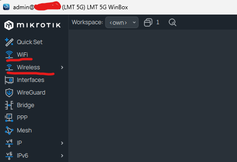

I think You can manage new AX devices from LMT 5G router without problems. If I’m true you should see two diferente menus on LMT 5G, one is “Wifi” and second one “Wireless”. At least I see them on my LMT 5G device.
Under “Wifi” you can configure new version of Capsman even if you not have installed wifi-qcom-ac package. At least I did it from device which doesnt have new ax wifi interfaces.

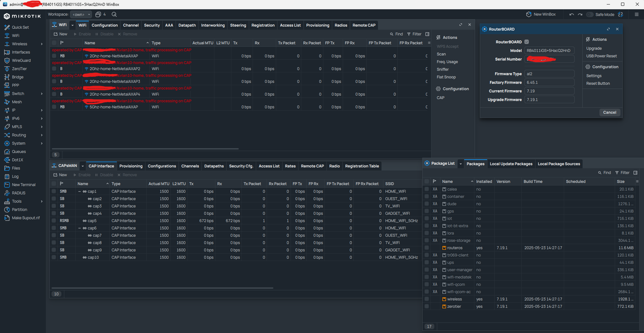

I didnt configure them on LMT 5G but on my own RB4011iGS+5HacQ2HnD which also doesn’t have new wifi ax, but have both menus like on LMT 5G, so basicly I could do it also on LMT 5G. I did configuration on my own device, because when I will need to give back LMT devices, I will not lose configuration. So my network brain is my RB4011iGS+5HacQ2HnD device with old and new CapsMan Manager enabled. And yes I’am also controling LMT 5G device with it, tricky part was LTE pathrough and vlans, also i’m not sure if it was good idea :smiley:
So my guess, you can capsman your new device with lmt 5g.
Picture of device without wifi-qcom packages controlling 3 access points, one ap on same device, one ap on lmt 5g device and one ap on netmetal ax device(new wifi6). All working with same SSID and so on.
