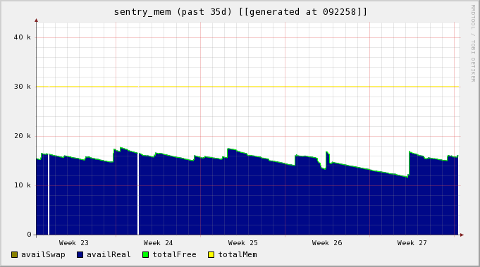

There was indeed progressive memory consumption, but not down enough to the point where it should have been unusable. There is usually 10-12 MB remaining free on my 32 MB RB532.

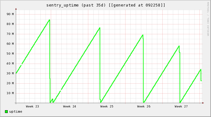

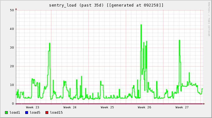

attaching RRD graphs of the past month, where you can see the trends. The Load Avg ramp-up usually starts 1.5-2 days before I reboot (or, in some cases, power-cycle). You can see it in the graphs.
