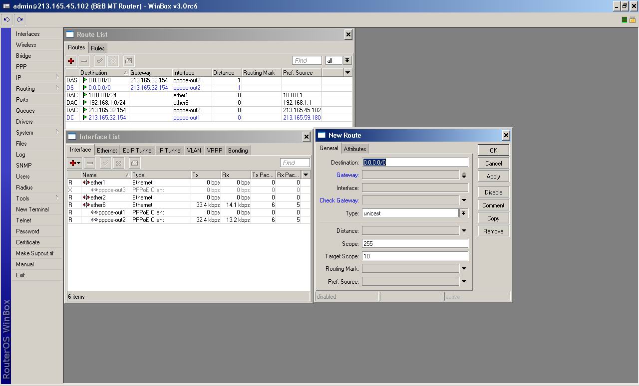

how do you create a new route to an interface?? this is great feature by the way.
but i tried to do it, the interface field cant be modified???
pls see attached shot

should work like this:
[normis@demo2.mt.lv] > ip route add gateway=
wlan1  wlan2  ether1  ether2
but that won’t help to load-balance. your ISP will give you two IPs of the same range which will cause more problems than benefits. the only realistic solution is having 3 routers.
Code:
Normis it doesnt work, look
[admin@Mult] ip route> add gateway=ether1
invalid value for argument address

ROS v3? p.s. maybe, add ‘address’ argument? :slight_smile:
