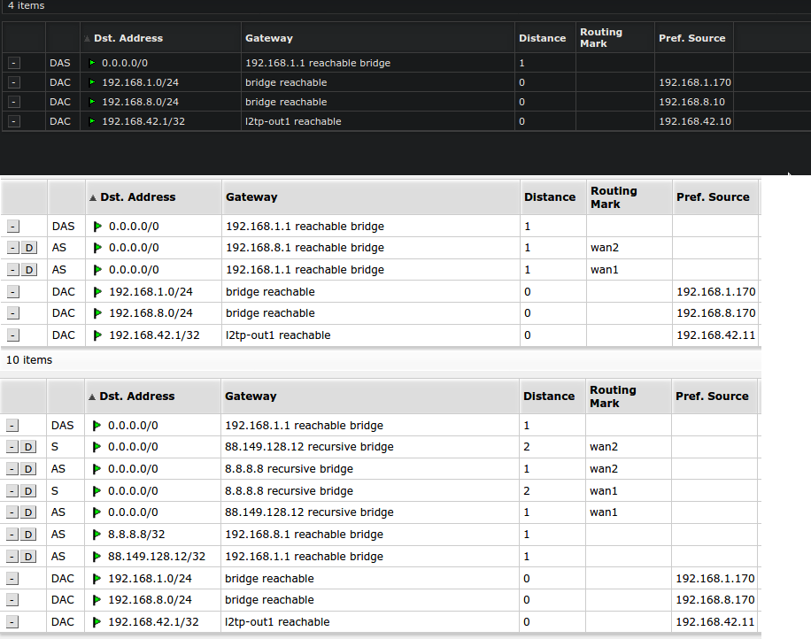

for the failover I modified the routes as you suggested I added these rules and the screenshot of how the routes changed.
add dst-address=88.149.128.12 gateway=192.168.1.1 scope=10
add dst-address=8.8.8.8 gateway=192.168.8.1 scope=10
add distance=1 gateway=88.149.128.12 routing-mark=wan1 check-gateway=ping
add distance=2 gateway=8.8.8.8 routing-mark=wan1 check-gateway=ping
add distance=1 gateway=8.8.8.8 routing-mark=wan2 check-gateway=ping
add distance=2 gateway=88.149.128.12 routing-mark=wan2 check-gateway=ping
In your opinion, is everything correct?
I don’t understand if the first rule in the list screenshot, automatically created by the bridge, should be maintained or deleted.
I don’t use this config often, but it seems ok. First route is probably from dhcp client, and it’s what RB itself will use, if it needs to access internet. You can disable it and add same two routes like you have for wan1 and wan2, but without routing mark, and it will give you the same failover.
