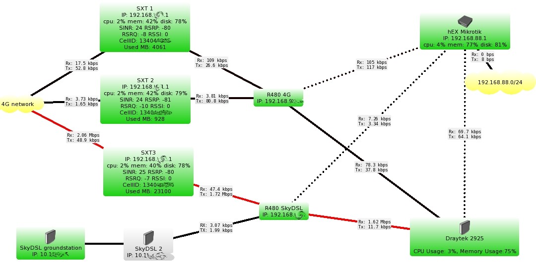

My current setup is in the DUDE picture below. The hEX only running DUDE, monitoring WAN and LAN. The Draytek is the actual LAN connection, doing 2-port WAN load balancing. The TP-link RT480 is doing load balancing. The hEX is using failover based on ip routes with scope setting and nexthop detection to set up a management SSTP tunnel home. De SXT LTE devices connect to a very distant 4G distribution.
As we replace all devices by Mikrotik, the RT480’s and Draytek will be replaced by 1 Mikrotik router. Want to go to 8 WAN links. (There are 20+ AP’s on the LAN side)
