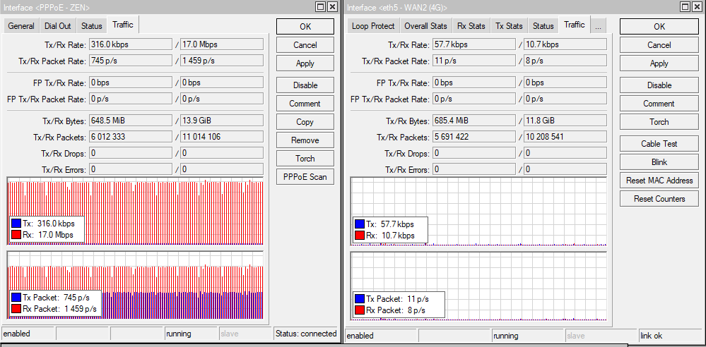

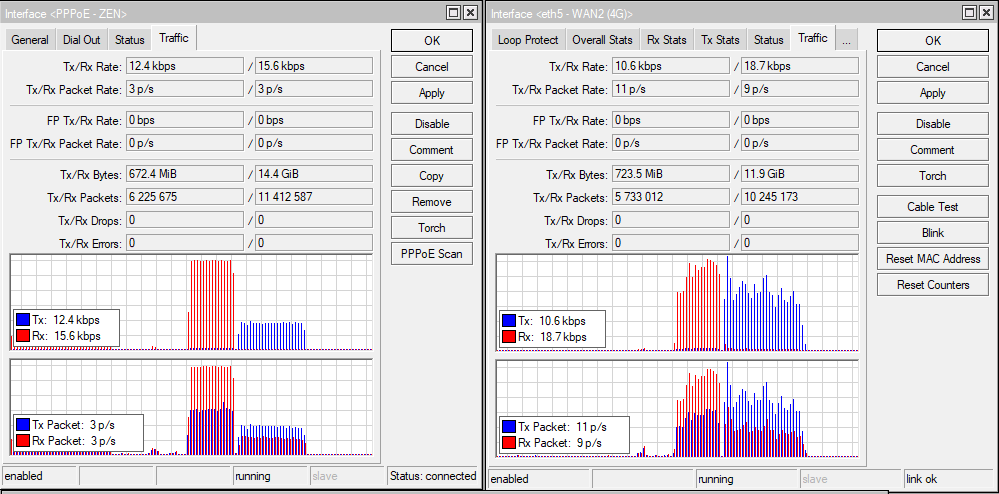

I have a similar setup, but I seem to have lost the feature of combined download bandwidth, however the upload remains.
So I have a WAN1 via 3rd party DSL modem and a WAN2 via 3rd party 4G router.
I used to be able to go on speedtest.net and whilst testing I was looking a the traffic graph for both WAN interfaces and I could see them maxed out on both download and upload.
Now it seems this is no longer applicable for download ONLY after a reboot/update?
The only thing I done since last time I tested was to add a mangle rule to force a specific LAN client (172.16.11.41) constantly on the same WAN (DSL) and some tinkering with the oVPN address and profile.
Any views, please?

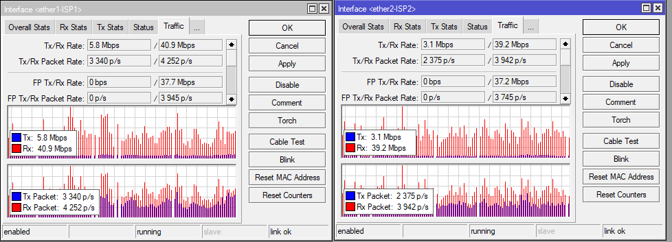

While running the speedtests, could you watch the actual bandwidth occupation on the WANs (/interface/monitor-traffic etherX,etherY)?

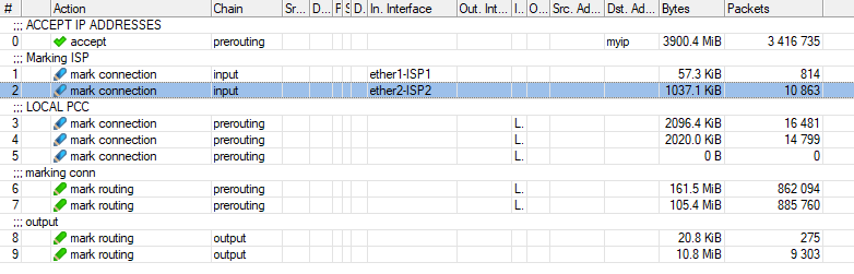

This is the images that I set
Filter Rules = I put this because to not let my client access my isp MODEM or allow then to tracerrout
NAT Rule
Mangle Rules
Interface
ISP Port Traffic

Well, the order of the mangle rules could be optimized a little bit, but that still doesn’t explain the throughput limitation. Anything configured in queues?
Thats why I am very confused right now and I don’t have a queues. Well, there is one that I haven’t tried. do I need to bridge mode the modem?

…so I noticed something interesting… if I test speed via Ookla (speedtest.net) I seem to be utilising both WANs on upload and download, but I also noticed whilst one of the LAN clients was downloading a big update file this was coming down only on WAN1, so no combined bandwidth. See the attached graphs for the client updating and the speedtest…
