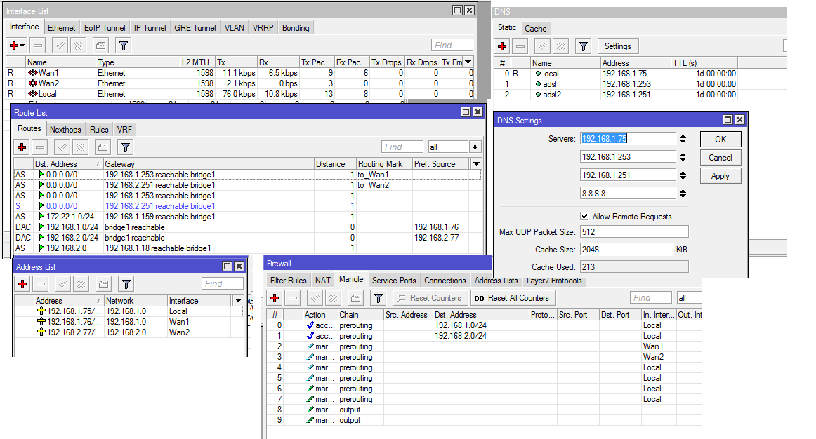

Hallo guys i have a problem were i have been trying to get my load balancing going between 2 ADSL routers but i cant seem to get the settings to work correctly. from the mikrotik i can ping all surroundings but from my pc i cant ping internet ??? i can ping local interface on mikrotik.
Tutorial i followed was http://wiki.mikrotik.com/wiki/Manual:PCC
i have a idea it might have something to do with routing …attached is screenshots of what this looks like and what my dns looks like.
i have a bridge connection which the moment i enable it the internet works but then the connection markings dont???

Do everything as is exactly described in mentioned example and check if it works.
Next make your ‘improvements’ like "Local’ and ‘Wan1’ interfaces in the same subnet :smiley:

OK guys after sitting for 3 days with this i figured it out…jippy. One needs to have the 2 wan interfaces and the lan interface on diffrent ip ranges . this enables you to route the traffic correctly.
Thanks for help.
