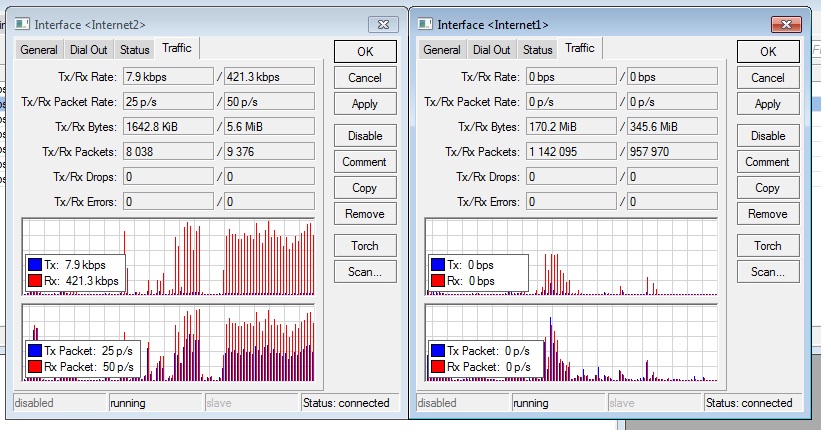

But im not sure if the whole "bridging connection thing: is working, cause if i go to speedtest.net with both modems plugged un it is the same and if one modem was plugged in and as the test was being done i was wating both PPPoE graphs and it seems to only use one while it was testing, not both.
but it does use both with normal browsing but im not saying at the same time, its just both graphs have usage on them.
Im not sure if my firewall rules are maybe incorrect,
but could some one please set me in the right direction?
Here is a print screen of when i was loading a video from youtube:

you can use both modems but you cannot join bandwidth
http://wiki.mikrotik.com/wiki/Load_Balancing_over_Multiple_Gateways
check this
it can divide your users in 2 networks
pcc can make loadbalance and load not combin
1 + 1 = 2
1 + 1 = 1 + 1
1 + 1 = ½ + ½ + ½ + ½
1 + 1 = ¼ + ¼ + ¼ + ¼ + ¼ + ¼ + ¼ + ¼
in other word more conection more balance
