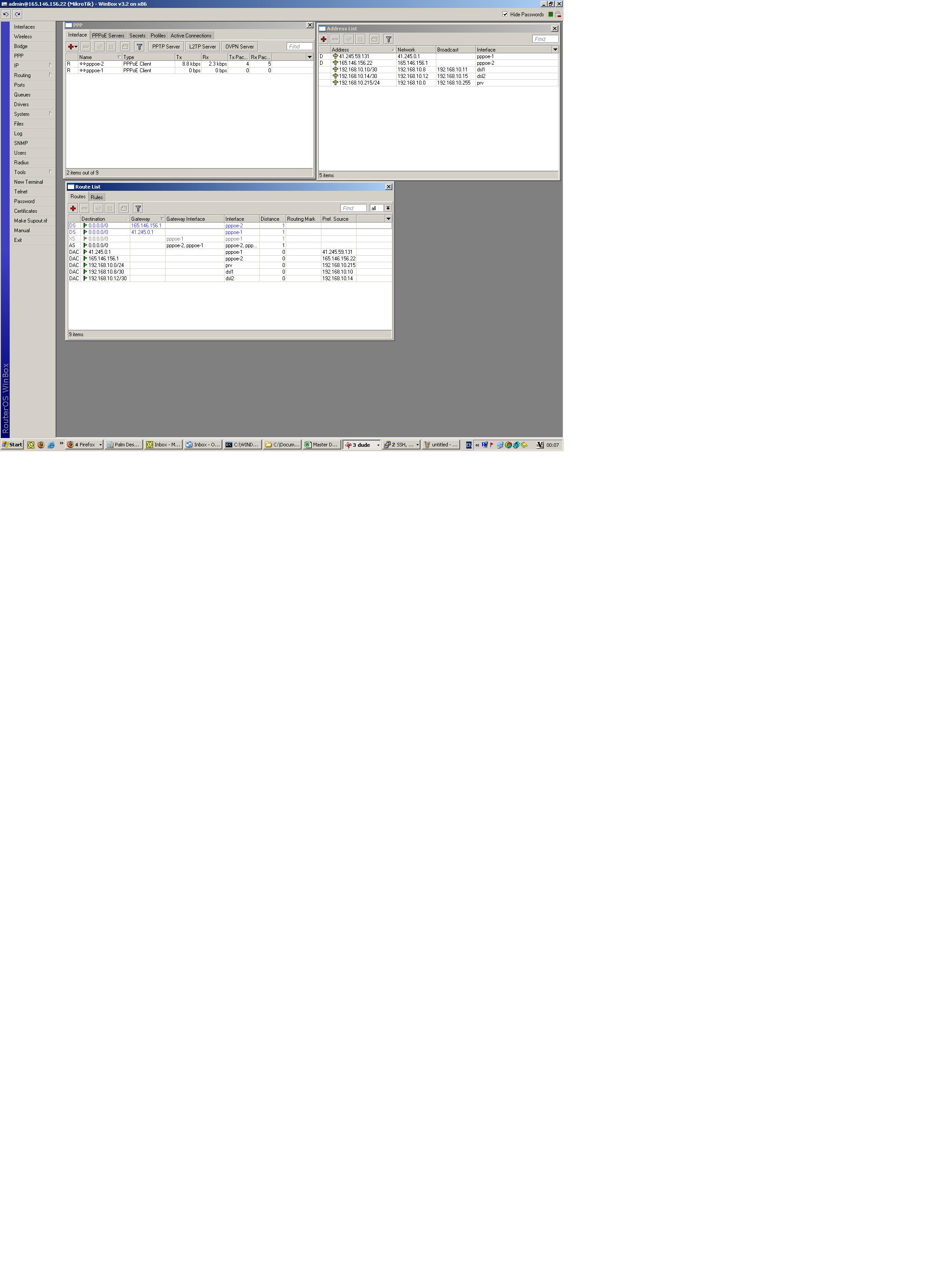

I am able to ping my mt for around 3 minutes and then am unable to until around 3 minutes pass.
Am I load balancing correctly?
Please see my setup in attached file.
Thanks and regards
Shaun

Hi shaunw,
Your problem is that both routes that are being assigned to your MK have equal distances. That means your router will use either route from time to time. So let’s say you ping pppoe-1’s IP address it will be routed out pppoe-1 for a while, then it will be routed out pppoe-2 even though you are still pinging the IP of pppoe-1. This normally isn’t a problem, except certain ISP’s (like the ones in SA) won’t accept source IP’s from one connection coming down a different connection. The only way to fix this is to make a new static route that will always use a particular gateway. This unfortunately won’t help you load balance.
Try this, it should sort out your problem:
/ip route add gateway=pppoe-1 distance=1 disabled=no dst-address=0.0.0.0/0 scope=20 target-scope=5
hope this helps.
Sorry, I only saw your reply today (I have now ticked the “Notify ..reply is posted” option). Thank you for the most informative reply. Are you suggesting that I add the route you describe to my existing setup? Thanks Shaun
