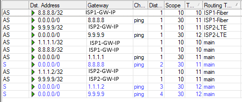

Checking 4 different ip’s, every pair have different route inside one ISP, to be sure it’s totally down
add disabled=no distance=1 dst-address=8.8.8.8/32 gateway=<ISP1-GW-IP> routing-table=ISP1-Fiber scope=10 suppress-hw-offload=no
add check-gateway=ping disabled=no distance=1 dst-address=0.0.0.0/0 gateway=8.8.8.8 routing-table=ISP1-Fiber suppress-hw-offload=no target-scope=11
add disabled=no distance=1 dst-address=9.9.9.9/32 gateway=<ISP2-GW-IP> routing-table=ISP2-LTE scope=10 suppress-hw-offload=no target-scope=11
add check-gateway=ping disabled=no distance=1 dst-address=0.0.0.0/0 gateway=9.9.9.9 pref-src="" routing-table=ISP2-LTE scope=30 suppress-hw-offload=no target-scope=12
add disabled=no dst-address=1.1.1.1/32 gateway=<ISP1-GW-IP> routing-table=main scope=10 suppress-hw-offload=no
add disabled=no dst-address=8.8.8.8/32 gateway=<ISP1-GW-IP> routing-table=main scope=10 suppress-hw-offload=no
add check-gateway=ping disabled=no dst-address=0.0.0.0/0 gateway=1.1.1.1 routing-table=main suppress-hw-offload=no target-scope=11
add check-gateway=ping disabled=no distance=2 dst-address=0.0.0.0/0 gateway=8.8.8.8 routing-table=main scope=30 suppress-hw-offload=no target-scope=11
add disabled=no distance=1 dst-address=1.1.1.2/32 gateway=<ISP2-GW-IP> routing-table=main scope=10 suppress-hw-offload=no target-scope=11
add disabled=no distance=1 dst-address=9.9.9.9/32 gateway=<ISP2-GW-IP> routing-table=main scope=10 suppress-hw-offload=no target-scope=11
add check-gateway=ping disabled=no distance=3 dst-address=0.0.0.0/0 gateway=1.1.1.2 pref-src="" routing-table=main scope=30 suppress-hw-offload=no target-scope=12
add check-gateway=ping disabled=no distance=4 dst-address=0.0.0.0/0 gateway=9.9.9.9 pref-src="" routing-table=main scope=30 suppress-hw-offload=no target-scope=12

\nip firewall/connection/remove ([find reply-dst-address~\"<ISP2-IP>\"])" host=9.9.9.9 http-codes="" interval=10s \
packet-count=3 packet-interval=2s packet-size=56 test-script="" timeout=2s type=icmp up-script=":log warning (\"GW2 LTE is UP\");\r\
\nip firewall/mangle/enable [find comment=\"NET2 <-> ISP2-LTE\"]\r\
\nip firewall/mangle/enable ([find comment~\"FOR LTE\"])\r\
\n:delay 3;\r\
\nip firewall/connection/remove ([find reply-dst-address~\"<ISP1-IP>\"])"
Looks like this
Thank you very much for your Help, I remember that from YT, I have done it after another search and both the config looks almost similar, but I will verify yours with the one I did to make it better ( I did mine yesterday since I was out of town for a few weeks)
I did not do the netwatch one! what is it for?
Thank you again
