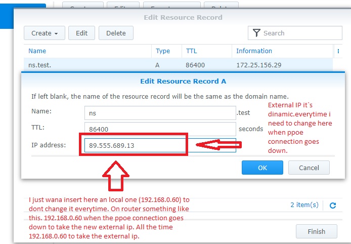

I have a situation like this :
  • 192.168.0.1 - hap ac mikrotik router (ppoe connection )
  • 192.168.0.5 - Synology NAS
On the synology nas i instaled dns server, i put my registered domain there . The problem apears when i just wana make nameservers for my site, request me and ip address. Its posible to make an local ip address dono 192.168.0.250 to take my public ip to dont change it everytime. Right now the i have 2 nat rules to dnsnat from ppoe connection to 192.168.0.5 on ports 80 and 443.

Thanks for reply,
I have an dns provided by my provider, but dns server on the nas allows me to put only ip address (not dns). my public ip address is dynamic, so i cannot put the public one. i just wana put on the dns server an local ip address and refresh automatically (on ddwrt i think its called dmz),because if i put my public address all the time i need to change it(if its local one no needed). i hope i was clear enough because i dono how to explain :smiley:
Thanks for reply
i have dns provided by my provider, i have my own domain and i just wana use it on my nas. for what i need its ok. i dont have an host for it, that s why i need that dns server on my nas. i wana put the local ip address instead put the public one (because all the time i need to change it). the no-ip i think dont provides me cname,ns,a . i just wana host it on my nas and i dono how to make the local ip address to take the public address just in local network to refresh automatically

What settings should make on the router to have something like in the picture.
That’s not what I meant. I still don’t understand what’s the ultimate goal of this. You want external IP address in internal DNS, but the question is what you’re trying to solve with this? You left out the whole thought process between the original problem and decision that running own DNS server on NAS would be the solution. Maybe it is, maybe it isn’t, it’s hard to say without knowing where you’re going with this.
I just wana host my site on my Nas, and i dont know how to do it, only to make my own dns server.
