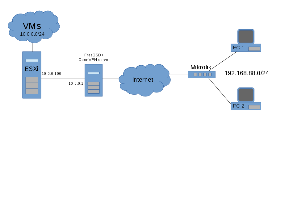

I have a Mikrotik with RouterOS v6.44.5. A small test network, the scheme of which is attached to the post.
OpenVPN client is configured on the Mikrotik. Ethernet mode. The connection works. The Mikrotik itself sees the network 10.0.0.0/24. But PC-1 and PC-2 don’t see this network. I deleted all the rules on the firewall and left only the masquerade. Can you tell me where to go to get PC-1 and PC-2 to also see the network 10.0.0.0/24?
Note: If I run the command “ping 10.0.0.100 -t” on PC-1 or PC-2 and reboot the Mikrotik, then the ping starts to pass. That is, it seems that when Mikrotik is loaded, the firewall is not loaded immediately, and while it is not loaded, the ping passes. But when the firewall is loaded, this constant ping begins to be regarded as an established-connection and continues to work until I stop it. But if I stop the ping then it won’t happen again. And this despite the fact that all the rules on the firewall (except masquerade), I removed.

The question is no longer relevant. In the configuration of OpenVPN server I added a line:
route 192.168.88.0 255.255.255.0 10.0.0.11
That’s all, everything was fine.
10.0.0.11 is the address that is assigned to the Mikrotik in the VPN tunnel.
