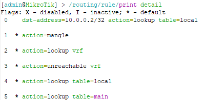

Starting from 7.22beta1, if you want that packet to hit the input chain, you'll need to manipulate the routing rule table, for example by adding this at the top, before the action=mangle default rule:
/routing rule
add action=lookup dst-address=10.0.0.2/32 table=local place-before=0

Routing rule to force the delivery from main to local:
/routing/rule/add dst-address=10.0.0.2 routing-mark=main action=lookup-only-in-table table=local place-before=0
