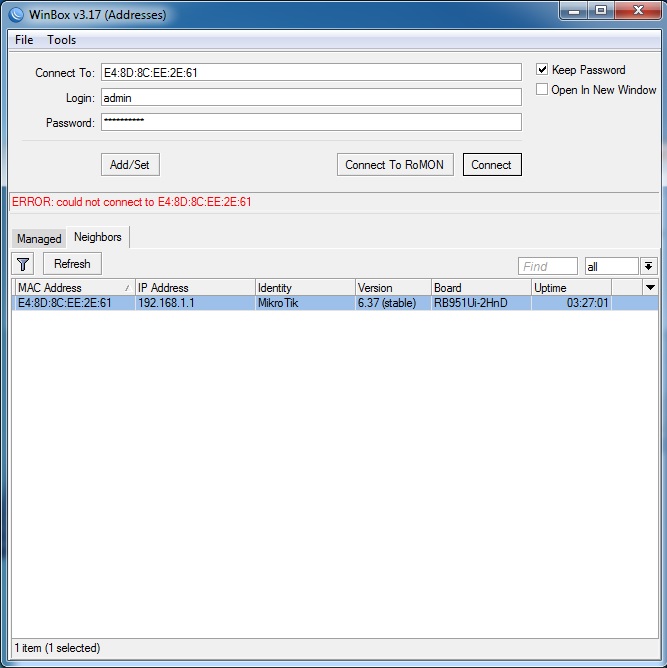

I’m stupid and i have disabled all the services ports, including winbox (8291) and ssh.
The MikroTik is working well, but I can’t connect to it. What can I do to restore access? I also have a physical access to device.
The model is MikroTik RB951Ui-2HnD there is no physical Serial port to connect through it and restore access. Resetting the device is my last last resort because i don’t have a backup config and i have allot of stuff configured inside that i cant configure them again!
Is there any solution for this case?
Neighbors shows my router mac address but when i try to connect i get an ERROR: Could not connect message.
Winbox via MAC address.
Open Winbox … click “Neighberhood” … wait for your router … click MAC address in the MAC column … fill user + password … connect
As i already have written in my post i have already tried to connect via Winbox >> Neighbors with no success when i try to connect i get an ERROR: Could not connect.
Do you have MAC address in the field “Connect to:” specified?
Yes i have look at the attached picture

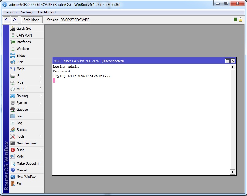

i have installed RouterOs on a VirtualBox and i have tried to use tools >> Telnet >> mac telnet
when i have inserted my Mikrotik router Mac address it asked me for a Login and password but when inserted the correct credentials it was not connecting and just showed Disconnected.
I have attached an image for you to see.
I’d say that mac-telnet client (=sw run on your Windows machine) asks about credentials even before it tries to connect to the other end.
There are settings for MAC servers (telnet and winbox), which by default limit access to connections coming in through interfaces members of LAN interface list. If you forget to update that list, then you might well get locked out of using MAC connectivity even though that was not intentionally. This lock-out is specially easy to achieve when VLANs are in use.
sorry same result as “gnarl”. shows disconnected.
