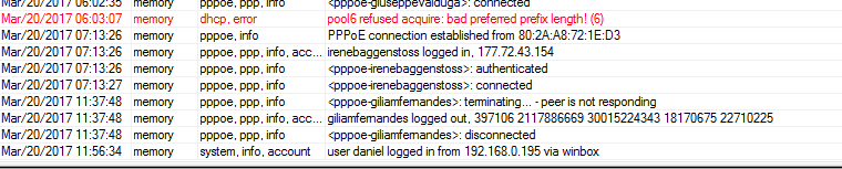

I’m having a strange log after upgrading to any RB for versions above 6.34, this is giving this log below: pool6 refuse acquere: bad preferred prefix length!
I use ubiquiti antennas with ipv6, my pool for the DHCPv6 PD is a / 48 with prefix length / 56
Someone can help me?

This log appeared after I updated the RBs to versions above 3.34
Versions Above 6.34*
Same issue here, I get the error log “pool6 refused acquire: bad preferred prefix length! (6)”.
I’m new to RouterOS and trying to setup ipv6 via pppoe. The Mikrotik router is the server, I defined an ipv6 pool, added it to the ppp profile. The radius is also sending a Framed-Ip-Prefix attribute. Both the pool and radius give prefix of /60. The client (Ubiquity EdgeRouter) is configured to expect a /60 too. Once the pppoe sessions is up it starts making requests to dhcp-v6 but I get this error in the logs.

same for me. Client is unifi gateway set for prefix len 64. I can provide packet capture if needed.
