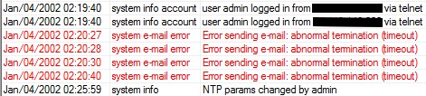

Log sending by email does not work on RB433 v.4.16
I set up sending log by email on other models of routerboards without problems.
But con not succed with this one.
In log I can see:
system e-mail error: Error sending e-mail: Abnormal termination (timeout)
also NTP client is somehow not working on this version.
Anyone have an idea?
