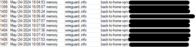

My logs show to much info. Only last 20 minutes are there and all 1000 slots are full. Basicaly every few seconds new info is added. I never dealed with system/logging so i dont want to make things worse.

picture of what info is logged

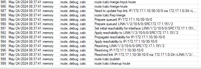

Simply add !debug to your personalized log rule.
That’s not true, for sure.

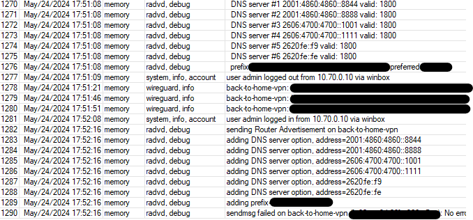

The default rules do not make “debug” logs, so someone, probably you, added “routing” to the logs, without the foresight of also putting !debug.
I'm not saying your statement is incorrect in this specific case but remember early 7.14 (I think) where all of a sudden wireguard and DHCP debug info appeared in log files without anyone touching those settings ?
So it can appear on its own, if it's a bug.
You have a point, one friend helped me with Wireguard flood so called him and he stated "I simply added !wireguard in logging". Based on baragoon suggestion i did export and discovered: /system logging add topics=!wireguard
after i remove it, debug info will stop but back to home vpn flood will emerge.
So i added !debug and !wireguard in expectation it will stop both. > /system logging add topics=!wireguard add topics=!debug
Well debug is still there so it is kinda pointless...
When roll to back to original (removing !wireguard and !debug)...
Seems like removing back to home connection is only way to deal with this, there is no way to change dynamic setup of this service.
I should stayed on 7.13.3 where everything worked normally. This new behavior is so weird for SOHO users.

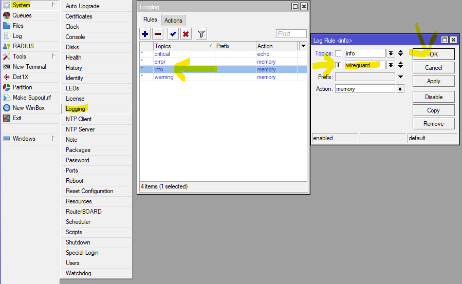

Thanks a lot! It is exactly what i wanted. I put there the winbox way how to do it for another SOHO users.
Also worth noting is it is NOT possible via wireguard app on phone because it is lacking ability to put “!” before wireguard.
