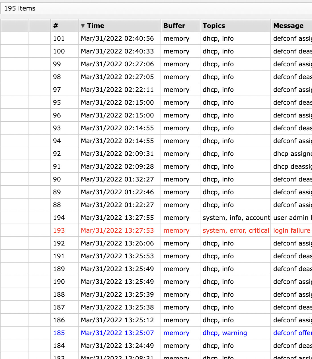

I havent noticed this in versions before 7.2.rc5 on my HAP AC2. The sort by date doesnt work in descending order. There appears to be a logic error thinking that log event 101 is newer than log event 194

I am trying to derive some logic but it doesn’t make sense indeed …
If column Time is used, it should sort correctly whatever there is behind the scenes.

There are no NTP events. The issue appears to be a logic error with the sorting descending and how it interprets the 24 hour times, ie it can’t handle whether 00-1200hours is newer or older than 1300-23:99 hours.
Sorting any other way works a treat. Sorting by Time ascending works fine etc.
