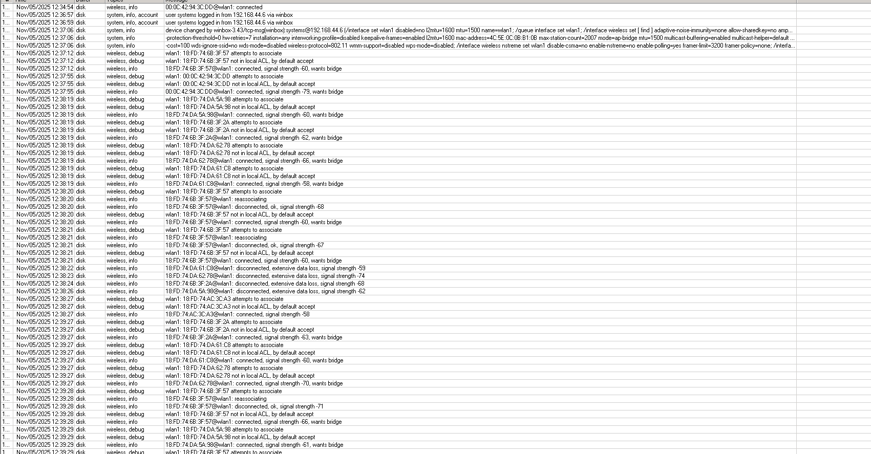

Log "xx:xx:xx:xx:xx:xx@wlan1: reassociating"
I have a cube60ad and I want to connect it to a 5 ghz point.
Where is netmetal via 5 GHZ and when I have nv2 turned on, the cube is connected fine, but when I switch to 802.11n mode so the cube connects for 40s and then disconnects and keeps going and the password is definitely good...
in the AP log, it says this: xx:xx:xx:xx:xx:xx@wlan1: reassociating
I have 7.20.1 firmware on the AP and I have tried the same 7.20.1 on the cube.
protection management is turned off... I think it is wpa because if I suddenly give 802.11, without wpa it holds up nicely.. I also tried wpa1 and it does the same thing..... can you think of anything else?
because it really only does it on that cube..

Are these all of the related log entires? Nothing a second earlier of a second later?
And what about log entries on cube60ad (station)?
and from cube:
https://ibb.co/Txk2nWVn
more for 18:FD:74:6B:3f:57
