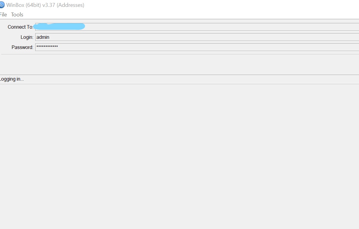

Hello For all MT Users and professionals…!
i am trying to access my MT router through public IP, so sometime i get this message -(as the picture below)- just logging in and it remain just like that without log in.
i dont have a firewall rule to block login from a public address…also as i mentioned that sometime i login normaly without any problem.
so why this happen..? anyone encounter this problem before..!?
how can i know that my ISP provider is not a part of this problem..?
First off: it’s a bad idea to allow winbox access from WAN. In past there were a few exploits of winbox access.
Second: winbox saying “logging in” and nothing more very probably means some device is (silently) dropping packets and winbox is re-trying to establish connection. As you can login sometimes, this either means that your firewall/winbox service config is slightly selective or that some entity (either of ISPs) blocks winbox access. To verify if it’s your router blocking it, you could run sniffer to see if winbox packets arrive to your WAN interface or not.
But, as I wrote in first paragraph, allowing winbox access from WAN is a bad idea in the first place. You should set up some secure tunnel (wireguard if you’re running ROS v7 or IPSEC otherwise) and run winbox through that tunnel.

so if i run a sniffer, what interface will be the target and if i opened using wireshark what i have to look in the sniffer file to identify the problem..?

Obviously it’ll be WAN interface (if your winbox access is open). And the sniffer contents? Let me google that for you …
You need a rule to allow 8291 on input before any drops. But given you’re saying it works sometimes, do you have multiple WANs? Because the router input traffic to router has to specially treated.

yes i have two WAN interface..!
