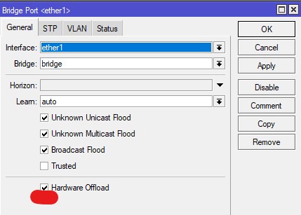

Your RouterOS version setup as you posted was using the RouterOS as a bridge.
The only thing that might be missing is the “hardware offloading” , so that the CRS309 is using the switch chip as it should.
(With default settings I don’t know if the hw=yes should be visible in the config or not, as I don’t have a CRS309)
https://wiki.mikrotik.com/wiki/Manual:Interface/Bridge#Bridge_Hardware_Offloading
It looks like the “hw=yes” is missing in your config ! All is done by the CPU, and that is very slow in a CRS device.
Tick Hardware offload in every port of the bridge. There is also a letter H in the bridge port overview if the Hardware offload is used.
EDIT: On a hAP ac2 the default for Hardware Offloading is “yes”. So it’s not in the config file. This setting is not documented as parameter for “/interface bridge port” in the Wiki,(https://wiki.mikrotik.com/wiki/Manual:Interface/Bridge#Port_Settings) so I can only guess what is default.
After I restore my configuration to when it was using RouterOS as a bridge, from WinBox GUI the Hardware Offload is checked even though it does not not say so on the exported configuration. My guess is that it is on by default and would only show in the exported configuration if you turn it off.
