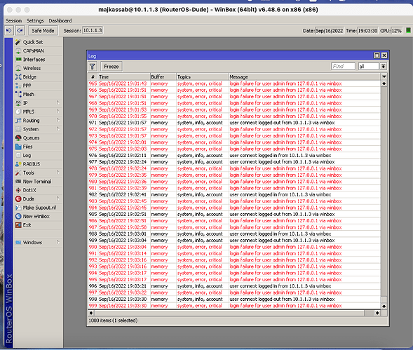

can anyone help me to figure why i get this error message " login failure for user admin from 127.0.0.1 via winbox "?

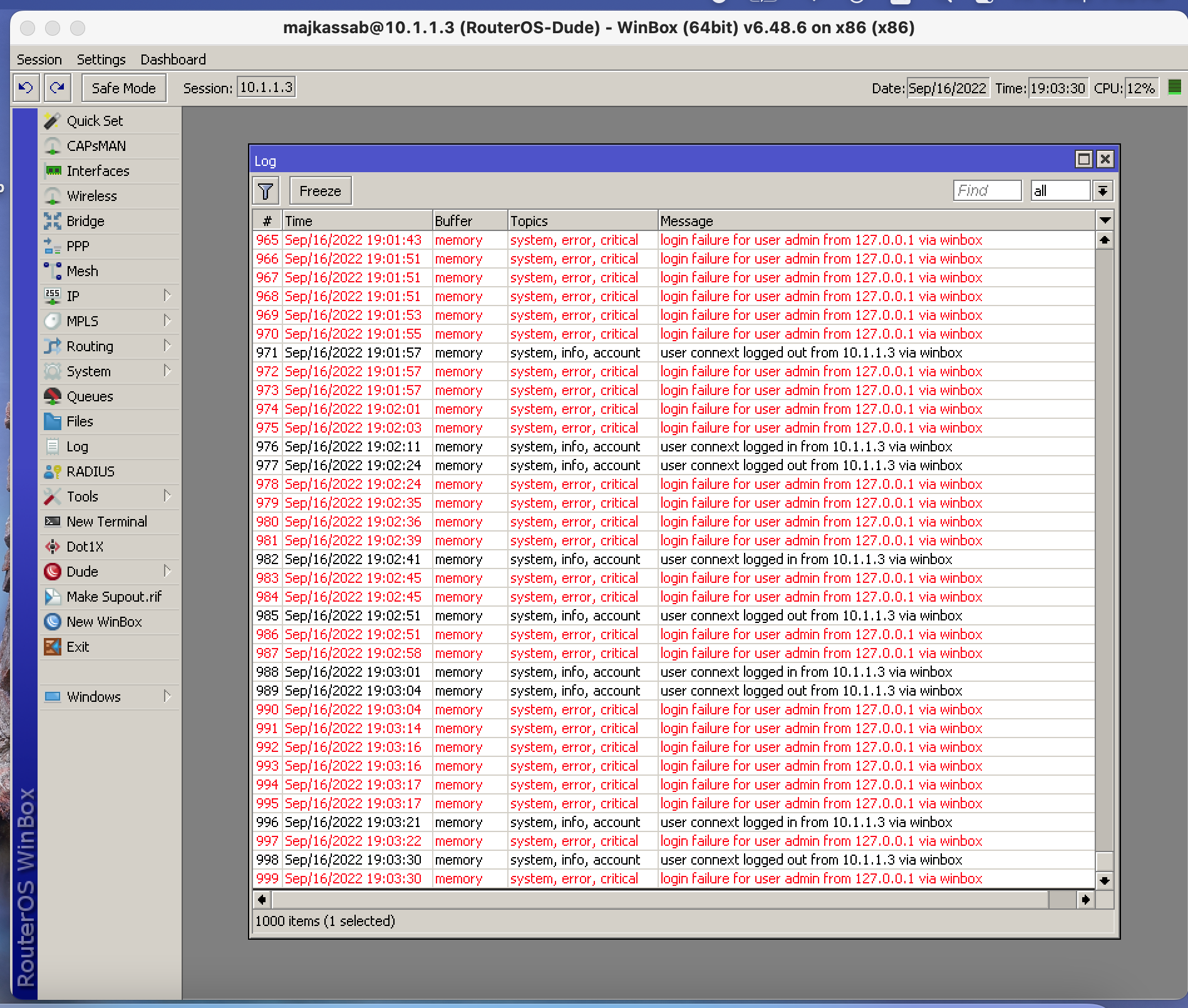

dear “Engr.” the link on signature is wrong,
and on your The Dude you have set the wrong password for The Dude itself.
Do not use 3rd party sites to host images, “Attachments” already exist on forum, and you must use that function.

Disable (temporarly) the dude. If the error logging stop. is clear that you have add the router itself to the monitored dude devices or agent.
Search on dude that device/agent and set correct username and password.
