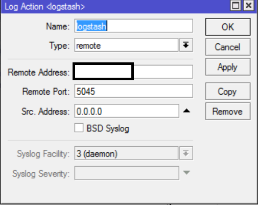

I’ve tried to add output rule in Mikrotik firewall (upd port 5045) and I see small traffic, but no changes, logs not displayed in Kibana. Please help.
Post also your RouterOS logging setup, please.
Sure. In Remote Address specified my local ip (logstash)

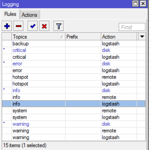

And is this log action also used? you must configure logging rules, which topics will have this new action “logstash”
Sure, logging rules was specified.
