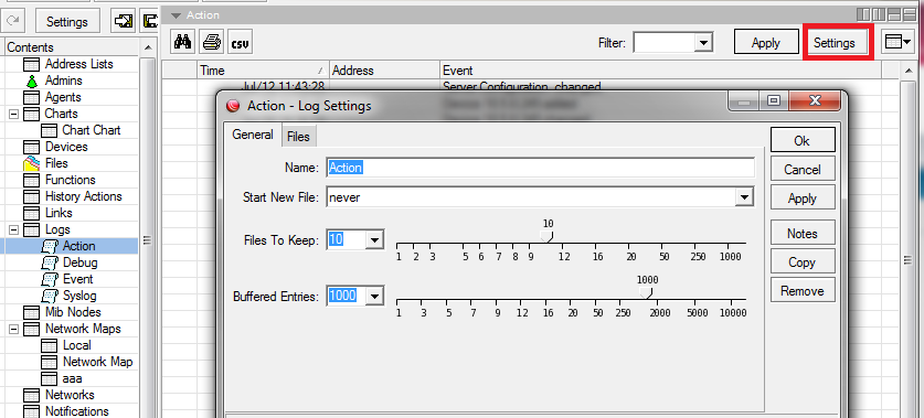

As can be buffered to remove entries from the log (Actions, Debug, Syslog)?
In the logs Action has more than 5,000 entries, which are not replaced.

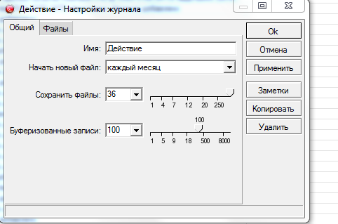

adjust log settings to reduce number of stored logs:
Now done this way. However, these settings do not work.

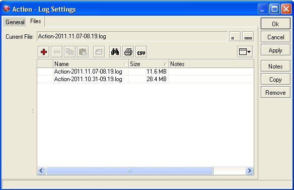

what do you have in the FILES tab?
1 file of each type of log.
delete those files and see what happens
Was removed. Create new files. Buffered records are not replaced.

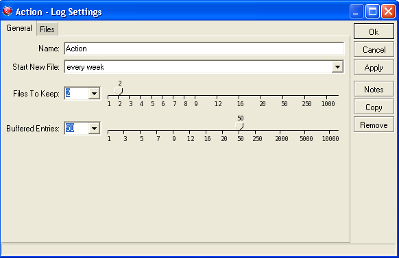

I use the following settings they seem to work fine.
The problem is solved. I renamed the default log name by others, rebooted the server. Created new log files with names by default. Old logs, I deleted it. Entries are now replaced with new logs, according to the settings.
