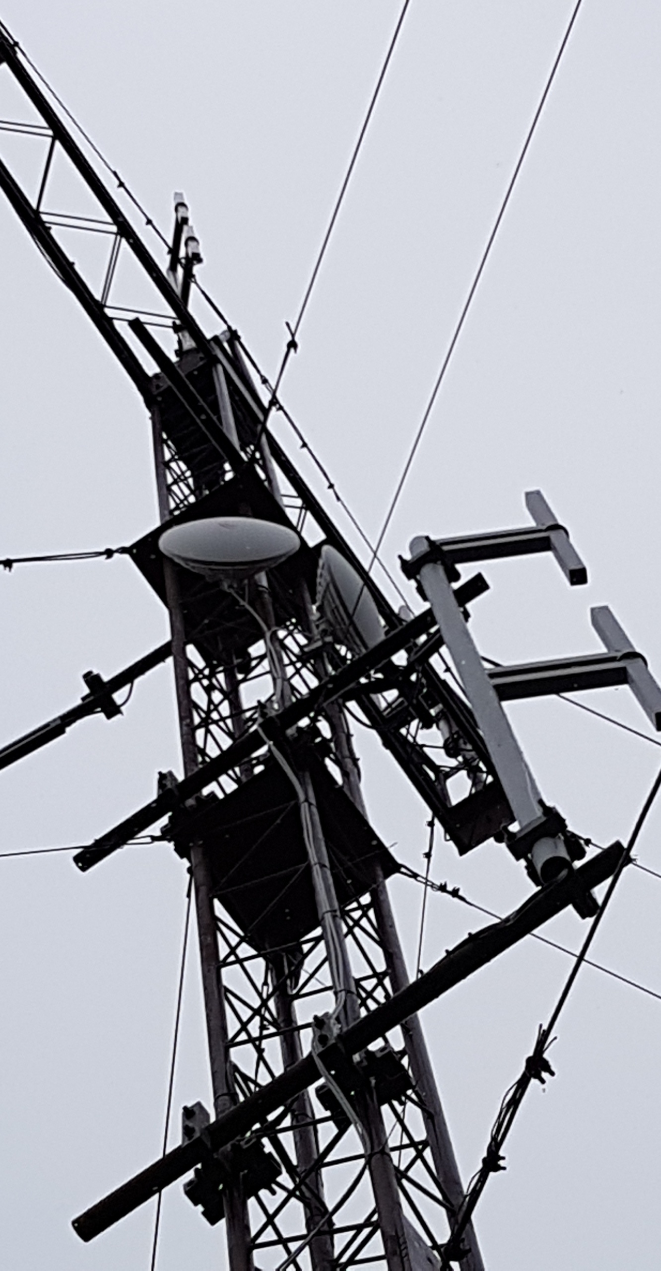

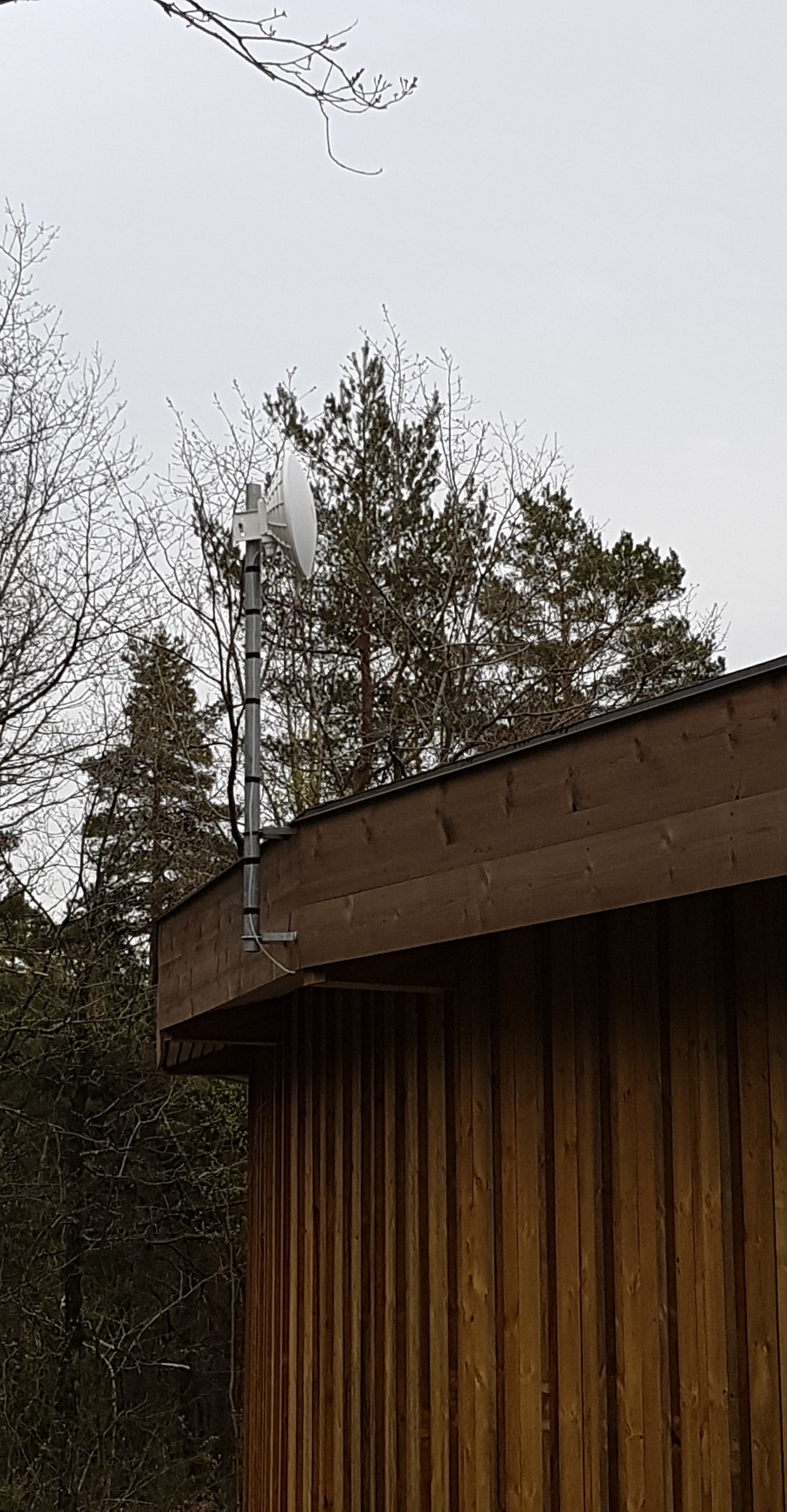

I have run a link for 2km+500m for quite a few years now, consisting of 2+2 dynadish.
The goal was to provide internet to a public hut in the forest.
Both “isp” and the hut have clear line of sight to a big radio mast I got access to. So the link is going to that mast, with a netpower to provide connectivity and POE to the dishes.
It has been rock stable, except for a PSU failure (probably lightning) destroying both dishes AND the switch. Now I have backup equipment.

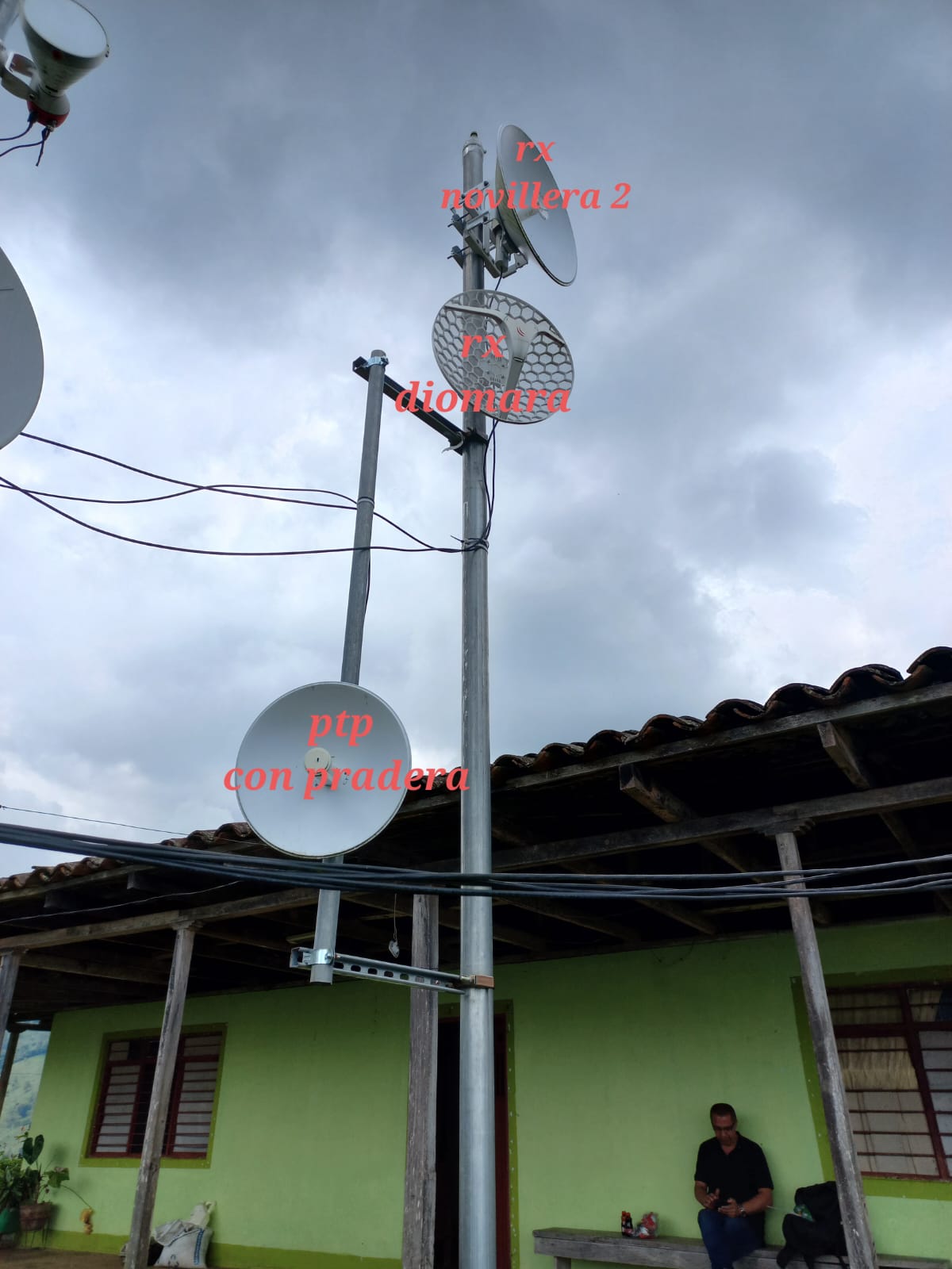

41 Km here!
RB912UAG-5HPnD on one side, NetMetal 5 on the other side. mANT30 with radome, NV2. ~ 100megabit link. One side is on a church at 340m asl, other side is on a 30m tower at 0m asl.

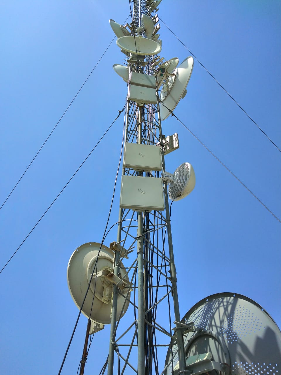

Well.. I don’t know how to prove that we installed these guys..but ok no problem.
and here is all the Mikrotik Gold devices that conected to this column -( from other sites also)-..sorry but really I can’t provide more info.

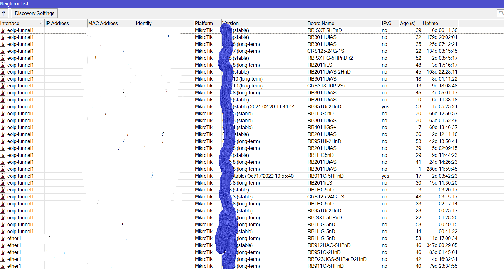

What about the distance of the longest links?
For me the Longest Distnace is 26.6 Km.
Please, for all of you, if someone wonders about this 26.6 km distance, I want to inform you that the speed is less than 40 Mbps. But it’s okay for us -at least- for this specific location, so don’t take this info as a standard to install LHG-5nD and expected a 500 Mbps at this distance.
