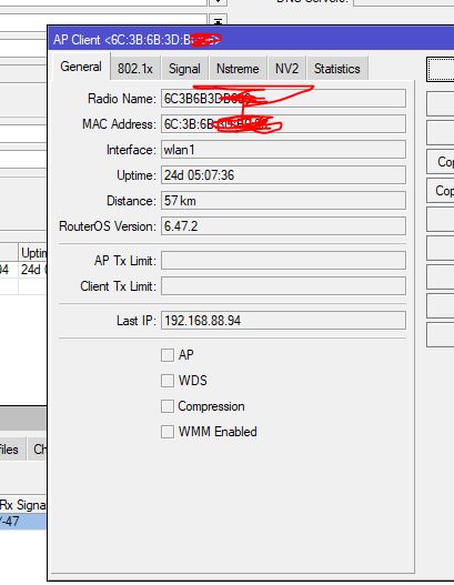

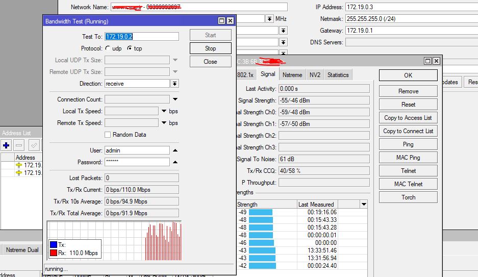

we have 57km ptp wireless link with netmetal5
is it longest ?
Post a picture of equipment. :slight_smile:
Add the picture to the post using Attachments, not just a link to en external site.
i didn’t take picture and i dont have access to the area to take picture
furthermore i use 34db dish antena with netmetal5
i did , thanks

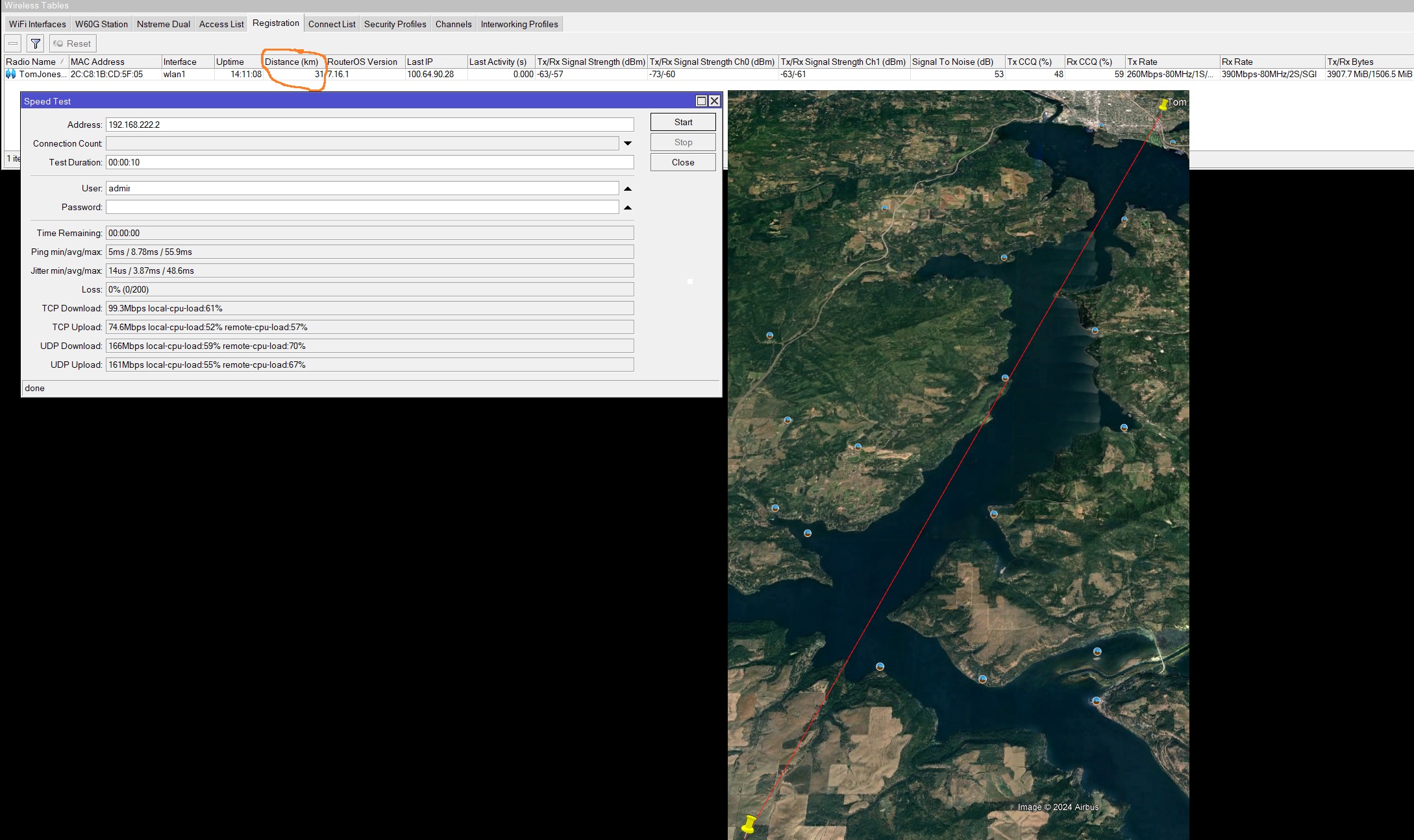

Normis - you asked for greater than (30KM+) MikroTik wifi based links?
I recently posted my greater than 30KM Mikrotik link in the Mikrotik forum → Solving 20km wireless link issues
This is a new 31km wireless link I configured yesterday. ( most of the link is over water !!! )
At both ends of the wireless link , I am using the following:
  • RB922UAGS-5HPacD
  • RF-Elements twist-port dish antennas
  • Wireless-Protocol: nv2 ( 802.11 will not connect at this distance )
  • NV2 TDMA-Period-Size: 4ms
  • NV2 Cell-Radius: 32
  • NV2 Downlink-Ratio: 80
  • Hw-Retries: one side is 7 and other side is 15 ( I am still dialing this in for best reliable throughput ) ( now 15 & 15 )
– Tower site elevation: 2973 feet + 80-foot level on a 120-foot tower
– Remote site elevation: 2345 feet + 20-foot level on top of a house ( FYI - my house )
– Lake level: 2142
– Average signal height above ground near both ends of the link: 60+ feet
This link has not been properly aligned yet - initial aiming of antennas was best guess where to point the antennas.
The link appears somewhat stable and useable.
North Idaho Tom Jones
