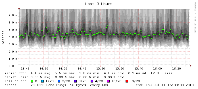

This is a jump NV2 MIMO 2x2

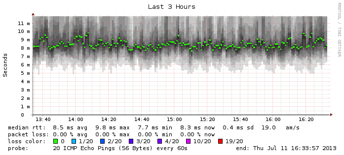

and this is the second jump NV2 1x1 MIMO together nearly 8ms! It’s terrible for TCP traffic.
