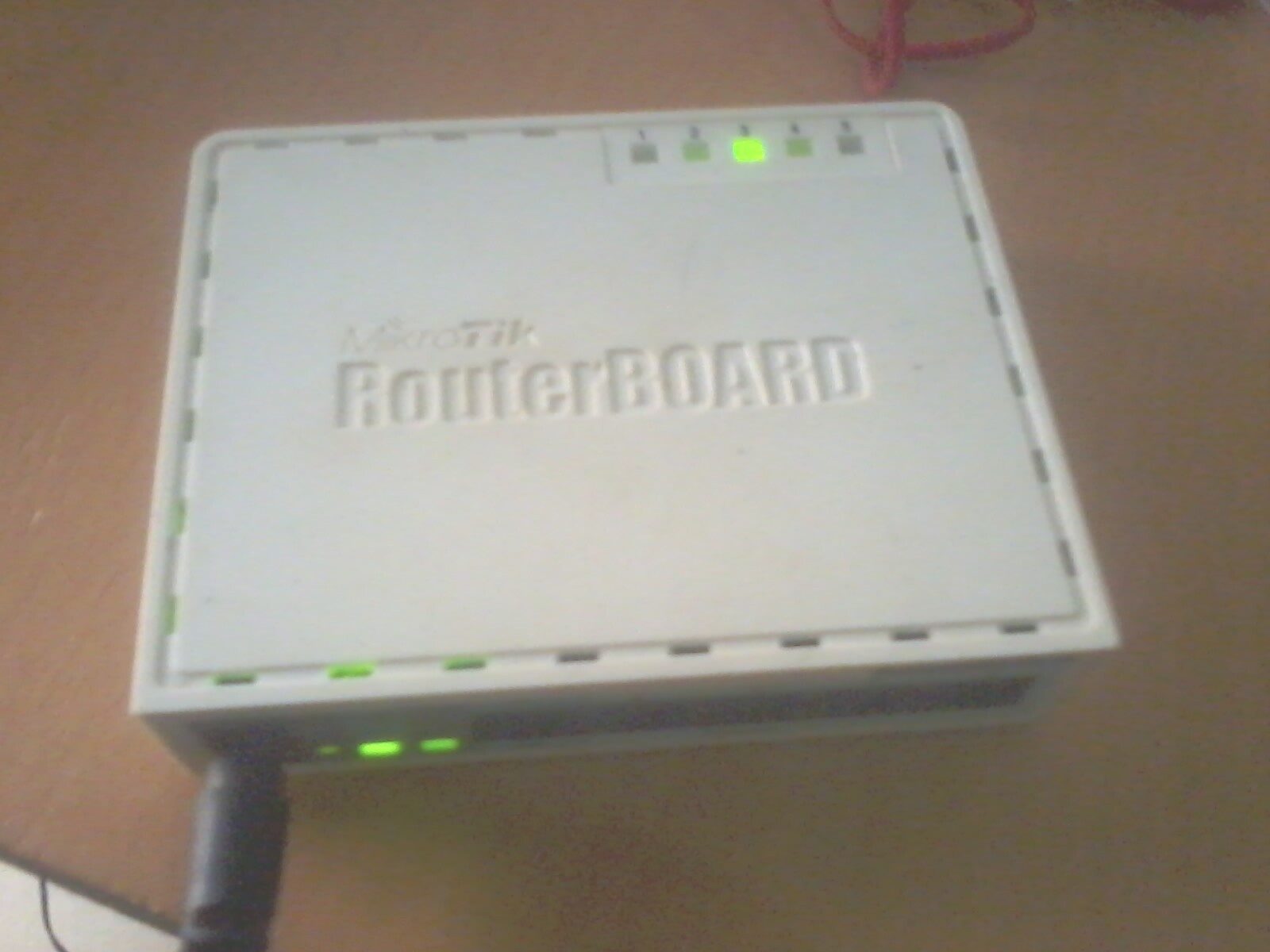

Look at this RB951-2N - strangest problem I've ever seen
the router lost power because the power extension board it was plugged in went off. now it’s on but deosn’t work.
as you can see from the picture below, no ethernet cable is plugged to any of the port but the LED for port 3 is always on.
I can’t even reset it after holding the reset button for 5 minutes!
I can’t get it connected via winbox because none of the ports will respond to being connected to an ethernet port.
what can I do? this router is barely a month old. :frowning:
I’ve seen this when ethernet port blown after lightning. If all ethernet ports dead, it can be repaired by replacing AR9331-AL1A chip.
