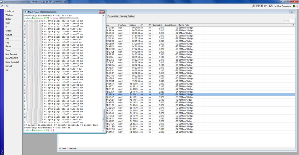

I’m a proud user of nstreme PTMP.
What version of ROS you used for your tests?
I would suggest using 3.30 with wireless test or 4.5 (remember to do a wireless interface reset configuration after the upgrade to 4.5).
I’ve the limit set to 40 clients on each wlan and each user is fed correctly with a low latency/jitter. Previously our bottleneck was the CPU of the Routerboard. Now we deploy RB411AH+R5H and they work flawlessly.
