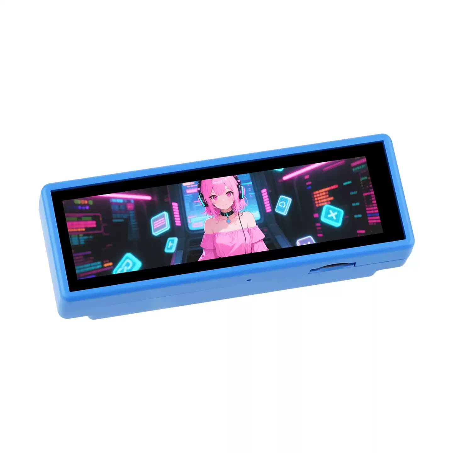

As a reference, I was looking at compact bar-type IPS LCDs like this 3.7-inch 240×960 MIPI panel
https://www.aptusdisplay.com/products/3-7-inch-240x960-ips-rgb-mipi-bar-tft-lcd-display
but I’m not sure whether this kind of display makes sense in real MikroTik deployments.

And no, though it’s useful for other systems I don’t see any value for Mikrotik, as if there’s anything to check I can just Winbox in. In the field like colo, what you may need is a large display to show dozens of RouterOS at once instead of a 2” which can only show very minimal info.
A dashboard, but so tiny that anyone over 50 won't be able to read it?
A 1U is 44.45 mm, it will fit a 3.99" inch screen of that type:
https://www.aptusdisplay.com/products/4-inch-400x960-rgb-mipi-ips-bar-type-lcd-display
or a 4.6":
https://www.aptusdisplay.com/products/4-6-inch-320x960-rgb-mipi-interface-ips-bar-type-tft-lcd-display
With 2 U it may start to become readable/useful as a 8.88" screen should fit in the heigth.
https://www.aptusdisplay.com/products/8-88-inch-480x1920-mipi-interface-bar-type-lcd-display
or a less elongated 5":
https://www.aptusdisplay.com/products/5-inch-780x1280-industrial-lcd-module
But how much would the device sell for?
Something in the less than 100 US$ range or more likely in the 150-300 US$ one?
Or more?
For people used to buy racks at the (stupidly high) rack prices of the market and used to non-Mikrotik "professional" devices, even 300 US$ is a rounding amount, but for the rest of the people it would probably represent (IMHO) an unaffordable gadget.
