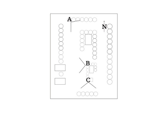

Looking for feedback on deploying multiple wifi access points
I’m looking for community input on configuring access points (APs) across a yard site. Each of the circles in the drawing is a metal grain bin ranging from 30 to 70 feet in height. The square buildings have metal roofs and metal sides.
A, B & C are three locations of mANTBox ax 15s (L22UGS-5HaxD2HaxD-15S-US) Wi-Fi access points. The angles suggest the Wi-Fi antenna orientation for coverage. They are approx 2m from the top of the bins. The drawing is not to scale. The circles at the base sit 400m from point A. East to west would be a distance of 300m.
A point-to-point link connects the antenna at point A to point C. Point C is an 85ft tower. The point-to-point ends are above the bins. There is a fiber connection between points B and C. There is a fiber connection to point C from off the map. There you’ll find the edge router. All antennas are in the same VLAN.
My questions are:
Do I need to deploy CAPsMAN?
If yes, can you describe some benefits?
If yes do I need an additional router to manage the service?
Do all points use the same SSID or do I make them different?
Do antennas require placement within a single vlan?
Is a distinct VLAN necessary?
I will apologize upfront if I ask a lot of questions when you respond. I’m trying to learn from your experience. My journey with MikroTik began in the middle of 2025, when I built the network from scratch. I still consider myself a beginner. I am the single point of contact for network support, so getting it right is my sole responsibility.
If you have any observations outside my questions, please send them along. I would like to flesh out the design before I schedule anymore cherry picker visits to the antennas.
How Is the point-to-point link between A and C made?

Thanks folks for the responses. Phew, no one came out with comments that made me rethink the deployment. 65ft up on the end of a lift working on antennas is on the fridge of IT work.
Why the necessity for single SSID? I worked in a build once that had multiple AP all using the same SSID. It was difficult to troubleshoot from an RF perspective.
What are the technical advantages for common SSID?
I'm not sold on CAPsMan.
What load does it introduce if I deploy the manager on the edgerouter RB4011?
My AP configurations are stable, no change. The three AP's are static. Fire and forget is my approach. The placement of the antennas cover blind spots. Point B was the first antenna deployed. A&C points came later as complaints of coverage increased.
The east side double row of bins is a blind spot alley. There a plans for some bin upgrades in the future that might open up the opportunity to place and antenna to cover that alley.

The environment has been a challenge. In addition to metal the height and using cherry picker to access it unnerving. Point C is 85 feet up. Access is via spiral stairs and ladder. Looking down is just metal gratting.
The final AP at point C has yet to be installed. The other two have been in service for a week. Still waiting for first complaint.
