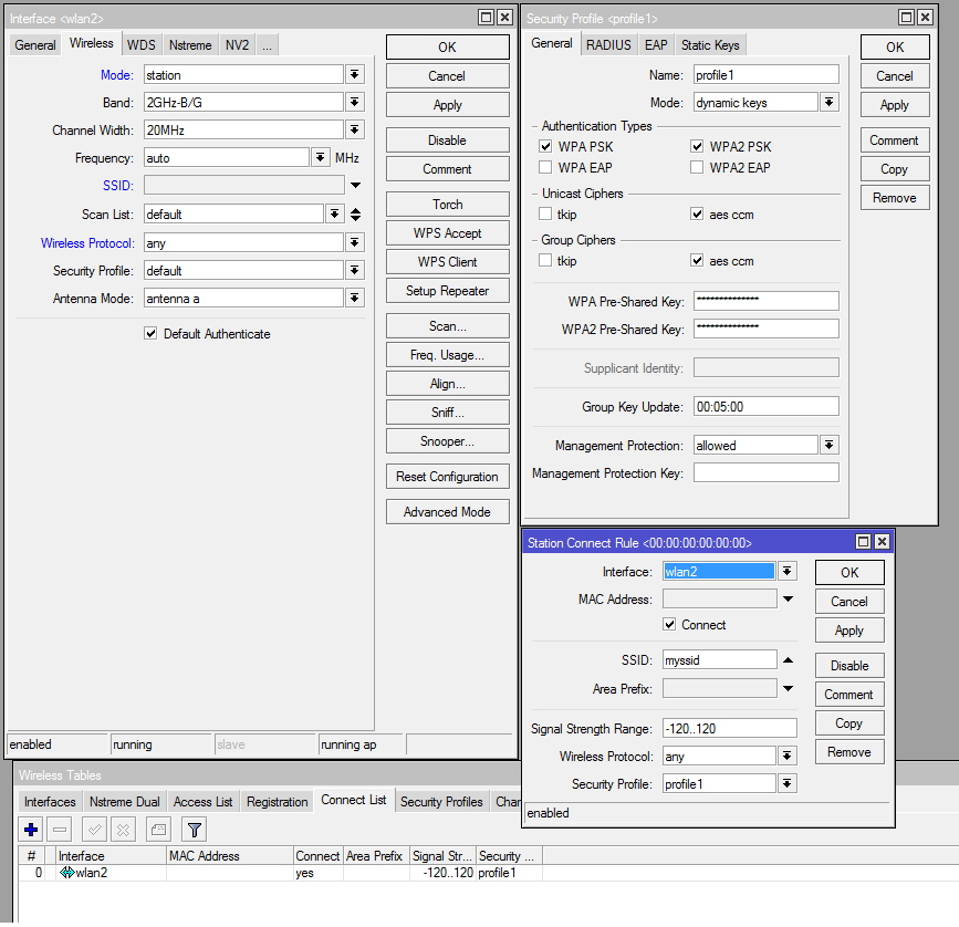

You should be able to connect to any WPA2 secured network by configuring the profile correctly otherwise the UniFi is using some proprietary protocol u cant connect to it. But if you can connect with other devices like smartphone or laptop then you should be able to connect with mikrotik too. First check your security profile configuration maybe there is something wrong there. second make sure you have selected the security profile on the wireless inteface settings. See if your wireless interface is part of a bridge also.
Another configuration i would sugest in your case is to configure your wireless interface to connect to any avalible network by choosing station, not select any ssid, wireless protocol any, security profile default (defaut profile mode set to none) then add some entry to the connect list with other security profiles and ssid’s. Mikrotik will connect to the first network that satisfies the connec list then search for any other open network. This way you can add as many profiles as you want. can achieve this by going to the wireless section not by quick setup ofc but you need to add the profile only once per network then mikrotik will connect to it while near. Hope it helps

Is your screen capture from WinBox? I do not use any version of Windows, have not since 1999, so I have never seen WinBox.

Winbox and webfig have an identical interface almost. You can do the same thing he was showing in webfig in the same place.
