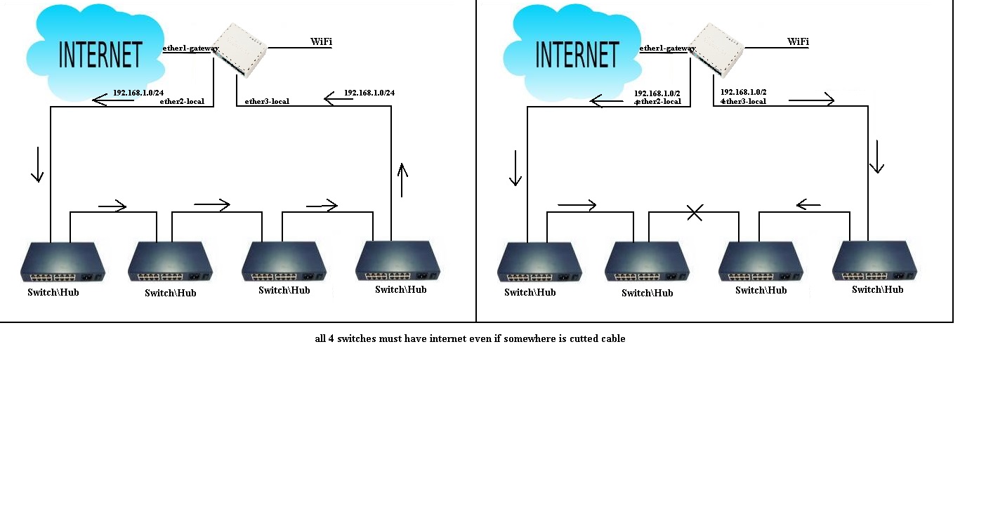

I wanted to ask is there is possible to make something like loop network? I mean like connecting switches to mikrotik and make them return to it.
And if somewhere between switches would be cutted cable it won’t stop switches from getting internet connection. I made a diagram about what I’m trying to say. I hope you’ll understand.
Make sure your switches talk RSTP and also set your local bridge mode to RSTP.
Then you’re absolutely fine.
Look here. And read the linked Wikipedia articlae about STP.
-Chris
