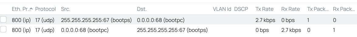

I noticed that the rule is constantly dropping some packets.
By enabling logs for the rule, I can see the following message every second.
19:25:14 firewall,info input: in:lo out:(unknown 0), connection-state:new proto UDP, 0.0.0.0:68->255.255.255.255:67, len 328
19:25:15 firewall,info input: in:lo out:(unknown 0), connection-state:new proto UDP, 0.0.0.0:68->255.255.255.255:67, len 328
It seems that the loopback interface is sending DHCP requests every second, and since this interface is not in the LAN interface list, it is being dropped.
[@RB5009] > /tool sniffer quick port=67 interface=lo
INTERFACE  TIME   NUM  DIR  SRC-MAC            DST-MAC            SRC-ADDRESS          DST-ADDRESS                  PROTOCOL  SIZE  CPU
lo         0.594    1  ->   00:00:00:00:00:00  FF:FF:FF:FF:FF:FF  0.0.0.0:68 (bootpc)  255.255.255.255:67 (bootps)  ip:udp     342    2
lo         0.594    2  <-   00:00:00:00:00:00  FF:FF:FF:FF:FF:FF  0.0.0.0:68 (bootpc)  255.255.255.255:67 (bootps)  ip:udp     342    2
lo         1.599    3  ->   00:00:00:00:00:00  FF:FF:FF:FF:FF:FF  0.0.0.0:68 (bootpc)  255.255.255.255:67 (bootps)  ip:udp     342    2
