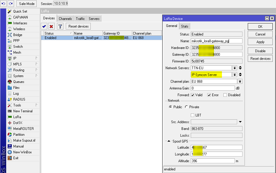

I have configured forwarding to TTN and private LoRa-Server at the same time on my MikroTik LoRa-Gateway → see Screenshot 1a & 1b
I’ve been running the Gateway for almost a year now and all data arrives correctly at TTN.

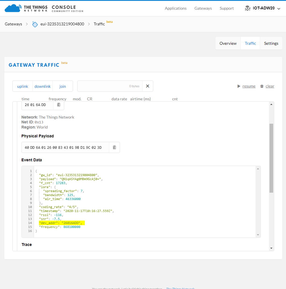

Screenshot 3 shows the TTN Console with the same record. Here I see ‘dev_addr’ …

Screenshot 1a :: Config Private Server
Screenshot 1b :: Add Private Server
Screenshot 3 :: TTN Console Screenshot
